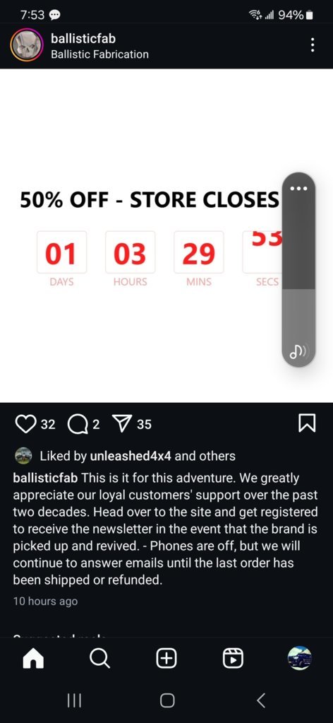

    Icon ex. Travel co's, spc uca's, bamf lca skids, 1" body, all pro heavy duty sliders, expo springs, BAMF shackle hangers, 14" bilstein 7100, rear frame box, custom rear frame crossmember, ifs skid, transmission skid, t-case skid(modified by @jeepandrew for exhaust reroute and more beef), custom k&n intake, flowmaster, diff breather mod, stereo with nav/speakers/subs, coverking tactical ballistic seat covers, Baja utility rack, lots of bed liner, anytime fog mod and steel braided brake lines, energy suspension rad support bushings, abs kill switch, cali raised ditch lights, fsr rtt. Lots of plans, little money....
    If anyone needs any "builder" parts....
