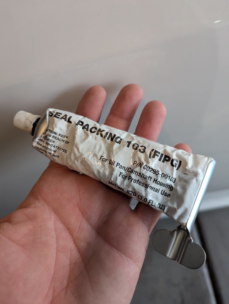

    I may have some extra Toyota FIPG @Yacob_D I'll be using more of it for my 3rd member.. but should be enough for the pan too. The FIPG is also what I used to seal my oil pan. Just take your time. Unbolt. Razor blade to break the gasket seal. Then slowly and lightly start prying with small flat heads evenly around the pan. Clean up flange with razor and whatever else needed to prep surface. Apply FIPG around holes and along flange. Let sit just a bit to tack up, then snug up hardware. Let sit again.. then tighten down.

    I found it.. this was for the oil pan for sure..
    But per my Amazon orders, now I think I used Permatex Right Stuff for the diff last time.. lol
