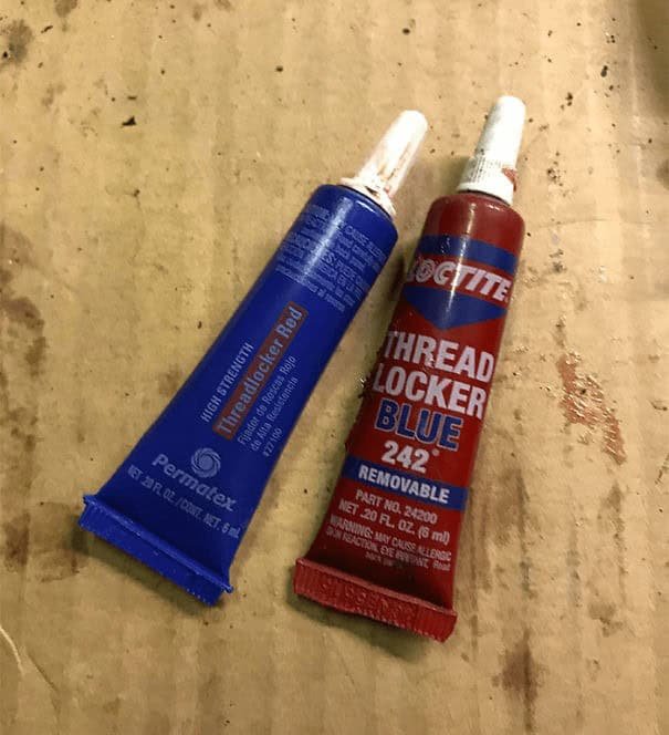

    They’re both the same. Don’t be afraid of red. If a 1/2” impact won’t free it then heat will. I use so much red I don’t understand the fear. It’s not permanent

    You're why I have to write corrective actions and 8D's :rofl::rofl::rofl::rofl:
    When you put red on a tiny weak bolt it's gonna explode long before the red yields, so you need to know someone was using red ("It's fine I used blue loctite from the blue toob!") and heat it with a torch (if you can heat it with a torch, it's probably already painted and you're going to give it a nice toasty marshmallow finish) and you have one shot before it snaps. Now your 800 dollar painted weldment is munted because you can't get at the blind hole in the machine shop either to drill it out because there's no way to fixture a whole ass seat back.
    And then Billy Bob says "it's fine I got this! I can drill that out by hand!!!" And he imediately misses and walks the drill down the side of the snapped off bolt.:bananadead::anonymous::annoyed:

    2021 T4R SR5
    It's a brand thing. Permatex corporate colors are blue and Henkel (loctite) corporate colors are red. I think they may have caught on in recent years that the average dude getting paid Wendy's nugget dunker money to assemble aerospace and defense parts can't be assed to tell the difference unless red is red is red and blue is blue is blue.

    Aerospace goes by part number and lot numbers as the project print notates

    I too cringe at the thought of 8D’s. Our corporate loves them but then won’t approve anything because they don’t have common sense and are disconnected from the problem.
    Im not saying you shouldn’t use the correct one for the correct application. But with a knowledgeable user, you could interchange them and get the desired results.
    Maybe just to make people cringe later I’ll soak a m6 stainless bolt in red and send it home into an aluminum block with the ugga dugga machine.
