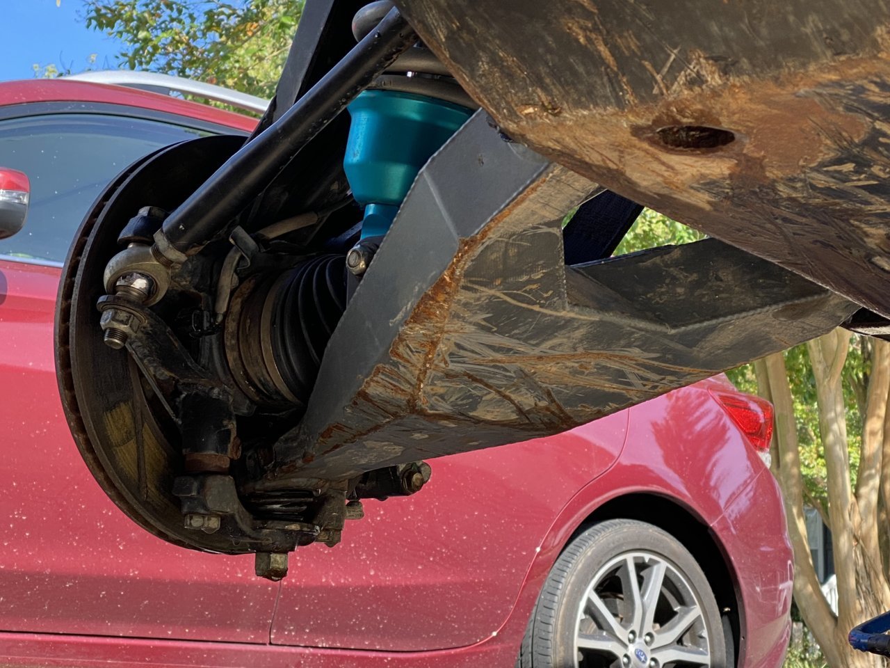

    I prefer having several hundred dollars of BAMF steel protecting my $75 Moog LCAs
    MR E30, time623, Bikinaz and 2 others like this.
