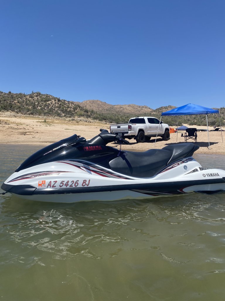

    Spent some time at Bartlett Lake today trying to stay cool

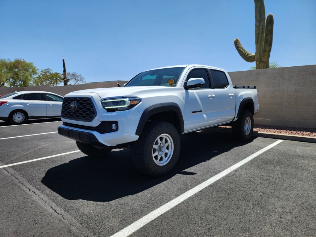

    Methods when back on, and got aligned and tuned! Not looking like an NPC driving around az with a bone stock white Tacoma any more.

    I was out there in my kayak this morning.

    There is nothing cleaner than a tastefully built white Tacoma :cheers:

    No kidding? If I had only known. I saw quite a few people in kayaks. I parked back in SB Cove and launched from there. It was very hot when I left at about 1:30.

    Well, at least you got a white one this time ;). Good looking truck!

    I almost went there but went to the Flats instead. I was out by the last set of no wake zone bouys before you start to go up the river.

    I was up there and turned around at the buoys about 11:00

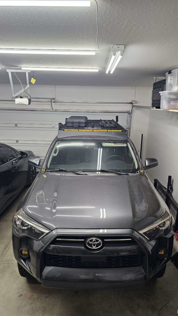

    Even just mounting the roof rack gubbins I was sweating my ass off today. Starting to think maybe a split mini in the garage is a good investment, but I don't have the handyman chops for that.
