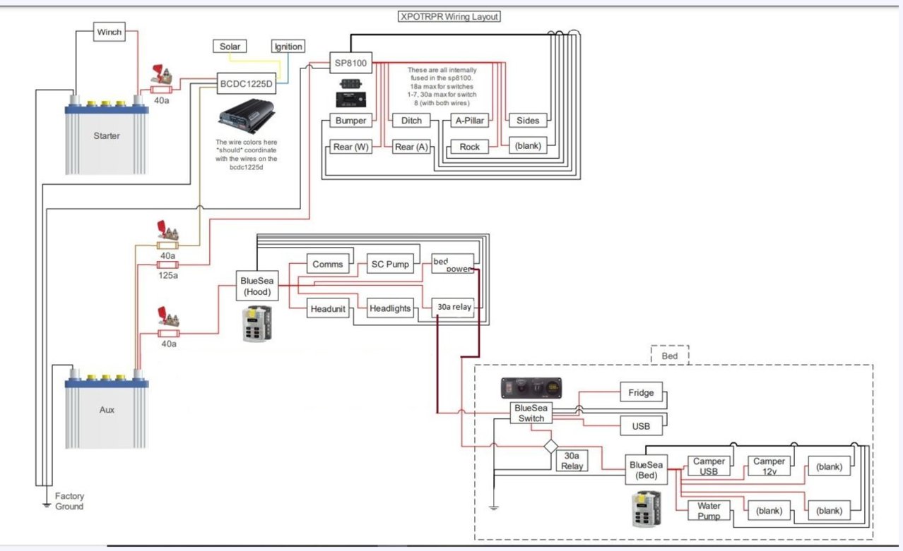

    Couple more revisions but this is it basically. OGE Split dual battery/Redarc system with all the appropriate wiring, terminals, fuses with correct amperage, etc. Details and Wire Gauge is all broke down in the PMs.. its all beef and future proof. Between my cart with OGE and Powertrays for all the misc wiring, terminals, fuse blocks, etc.. I'm at about $1300. plus all the little misc stuff I picked up. (12v pump, color coded 16g wire for accessories, wiring supplies, etc). Hoping to get some good progress on this all when we get back.

    Running everything through the factory ground, are you actually doing that or is that simply to keep the diagram clean?
    Any particular reason the winch is running off the starting battery?

    Just to keep it clean. Grounds will be to nearest chassis bolts/grounds.
    Just want to keep it separate.

    My setup is extremely similar...OGE and Redarc is the way to go, IMO.
    ETA: I'll be putting a BlueSea manual switch on my winch, though...extra peace of mind if I ever need to cut power to it in a hurry.

    Im guessing the BCDC has the ability to start off either battery or use one to charge the other if it gets drained? Are you running different batteries or two of the same?

    The Redarc 100% isolates the two batteries, but you can start the truck with the aux using standard jumper cables if the start dies. The beauty of the Redarc is that you can run different chemistries and sizes, unlike a traditional isolator, and it has a MPPT built-in.

    This.. the fact I can run different batteries was the biggest thing for me. IMO.. the Redarc is the simplest and best option out there.
