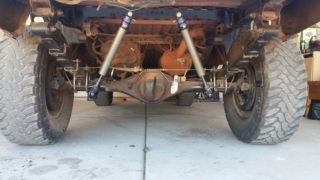

    You still have your rear crossmember in correct? I took mine out and basically replaced it about .5" forward with the new crossmember. That, and I angled my lower shock mounts down to compensate for the extra length.
    This is one of the better pictures I think to show the angled shocks and mounts.

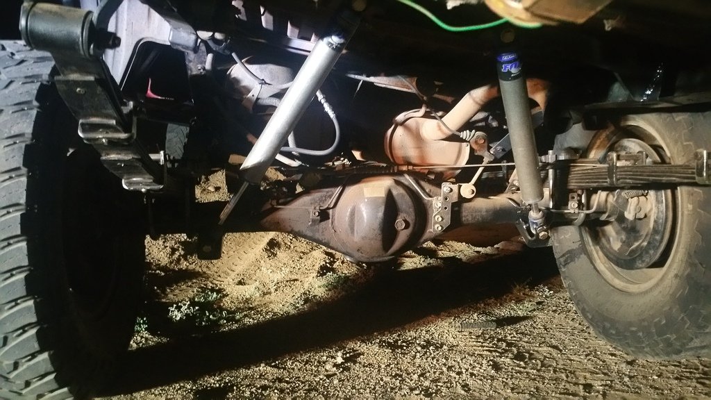

    Best picture I have to show bump and droop it with shocks at these angles. I think I have a little more droop, but you get the picture.
    If you remount, will you need more shock travel? E.g. the deavers have 12" of travel for example but you only have 10" shocks. To me, makes no sense in remounting, realizing you need longer shocks due to travel, and then get longer shocks and possibly remount.

    Yea that relocation really came out good! I kept the stock crossmember and added the new shock crossmember right in front of it.. from the pics it looks like you have a little more up travel than me because I kept the lower tabs parallel to the ground instead of angling them down for clearance.

    What type of valving did you do on the shocks when you mounted the that way /\. And if I get all the parts do you Guys think you could give me a hand with the welding on the cross member and what not.

    I thought I was going to have to move the crossmember back further about 2". Got lucky and didn't need too but I already had it off by then.
    And not yet. Haha. I have designed a bump pad, but need to get it milled. I have bump stops ready too, just waiting on the bump pad. :thumbsup:
    I got my shocks revalved by @05TacoRunner. He said he called DSM after fox wouldn't give him any info. DSM sent over their typical pack for this configuration. I don't believe Jason recalls the valving.
    Can't guarantee I can help with the welding personally as my roommate used a tig mostly. I don't expect him to do that again, though he might. I'm down to help though!
