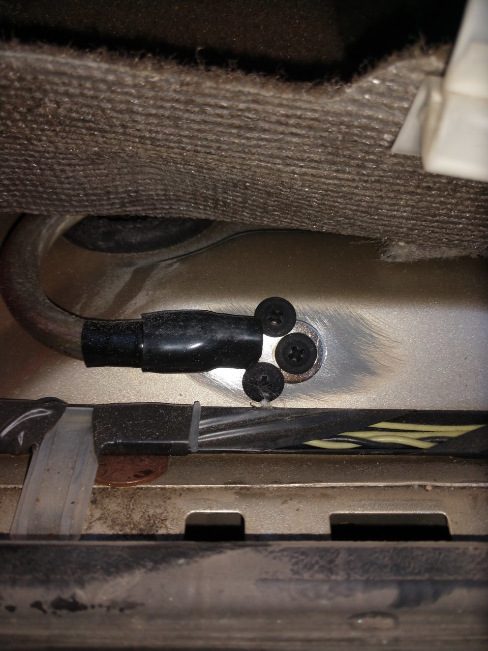

    So this is the ground, doesn't look bad to me? Maybe I'm missing something.

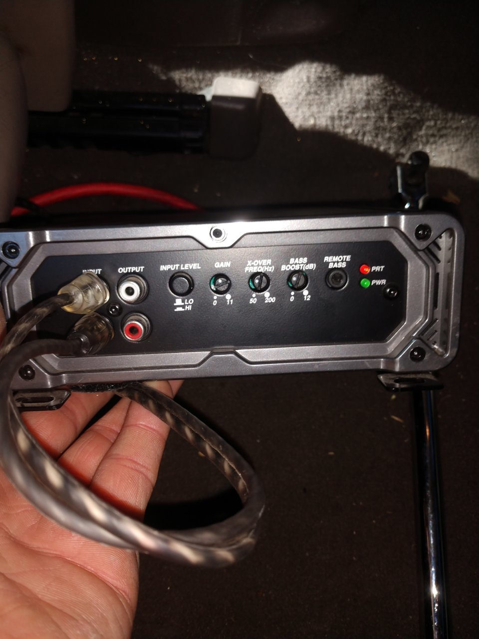

    My amp is a kicker cxa600.1. max is 600 w I believe. Today it was working then stopped again. I adjusted the gain and it still did the same thing. I don't want to take apart the dash so RCA cables will have to wait till later if I change my mind or another day. They seem kind of flimsy, maybe a better pair would affect anything? IMG_20180523_085120144.jpg

    If the ground is going to sheet metal then the ground is worthless. The best place is the frame. You can also ground to where the seats bolt in and it seems to be a decent ground in our trucks but it's not something I prefer to suggest.
    You are always welcome to swing by and I'll take a look at it real fast to see if there is anything really out of whack. I've seen some pretty sketchy installs done by professional shops (Cough cough audio cough express cough cough, best buy, cough, cough, a place really close to a local speed shop, cough, cough).
    Edit: Just saw the pic of your ground. That's not a good ground at all. Take the seat out, remove all the paint between the bracket and floor. Sand the bracket a bit as well. Use a wire terminal big enough to fit around the bolt that mounts the seat, use that as a ground.
    or.
    Drill a hold where this one is and run it directly to the frame. Sand the frame first. (This is what I'd do).

    No it was Fry's electronics, they were the closest to me so I went with them. I'm going to try the seat rail ground method and see how that goes. Do I have to only sand the one bolt where it meets the rail and floor, or the whole thing?

    Sand whatever it takes to make it bare metal against bare metal. No paint, coatings, rust, or anything else should be in contact with the ground. If you have a longer cable you can always run a temp ground back to the neg on the battery and see if your amp works.

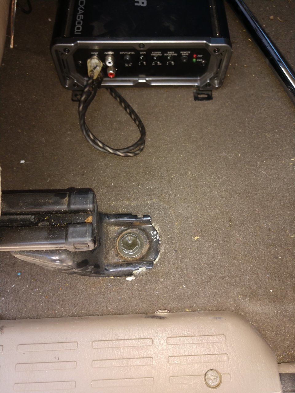

    So would this bolt be a good spot?

    Sand everything down real good and it should help.
