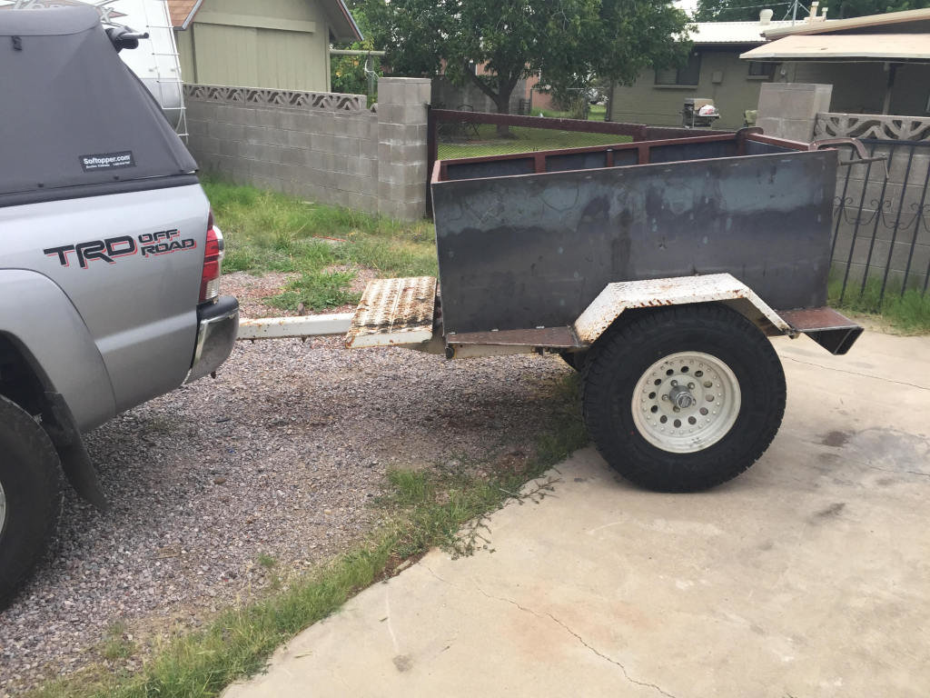

    Current state of my build.
    I recently acquired this trailer and I'm planning to turn it in to an off-road/overland/expo build.
    It has a 2000 lb axle and the box is 58x38 (roughly 3x5). As you can see it has a ramp-like overhang off the rear. It doesn't extend much lower than what you can see in the picture. I'm worried about the departure angle, what do you guys think? I could cut it off or I could cut it off, flip it upside down and reattach it. Or I could leave it. Thoughts?
    I welcome any other suggestions, feedback, etc. I'm really looking forward to getting started and posting pics as I go.

    I bet that sucker is hell to back up.
    I say if you want the extra room in the trailer you could flip it.

    I'd cut it and flip it.

    Looks like it's gonna be a sweet little trailer. I'd strongly recommend considering upgrading to a 3500# axle. If you're just hauling it around on the road you'll be fine with the axle that's on it but even on these small trailers the 2000# axles commonly fail offroad. I think the shock loads and general harder use they get offroad is just too much for them. I've seen several guys break spindles on their trailers with the smaller axle.
    Just a thought. Axles are cheap so it shouldn't be to much trouble to swap it out.
    Oh, and I agree with flipping the rear ramp.

    Thanks for the suggestion. I've actually been considering that, but it may come after the build is wrapped up. I can't just "flip" the ramp liked I had hoped I could. It didn't work out like i'd thought it might. But I'm good with a 5 foot bed, so I just chopped off the ramp. Check out the renderings I put together and let me know what you think. My rising rack system is inspired by yours!
