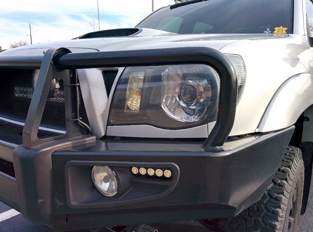

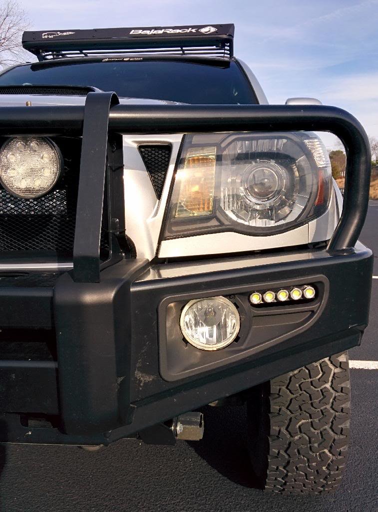

    Stock ARB lights that have never been hooked up since I got the bumper. Morimoto X DRL bought from TRS.
    [​IMG] drilled holes as far out as I could 6 1/16"
    [​IMG] Both drilled and ready.
    So far they look pretty good during the day I'll try to get some pics tonight. They act like small projectors, bending the light enough to have color flashes depending on your angle to them (blue/green/white).
    Wired mine through the factory fog light harness and switch because when I replace the ARB fogs I will use the Rigid Industries harness. They only need to tap into one wire then the harness powers both from that one source.
    The screw holes I drilled lined up perfectly with the ARB holes for the equipped turn/marker but I did have to get shorter screws (Stainless size 8, 3/4" length).

    X DRL only.
    X DRL and FXRs.
