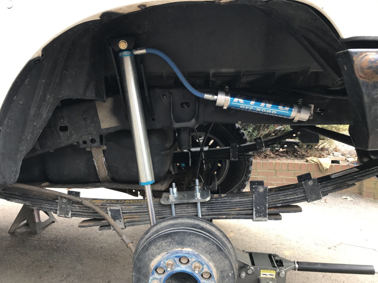

    Anyone have a link or a picture to how you mounted the resi?
  18. May 11, 2019 at 12:45 AM

  19. May 11, 2019 at 5:26 AM

    X2
    Just paint them before install because you can’t easily get to the back. I recommend the same for the shock towers. I painted the whole thing (after welding together) then just ground off the edges.
