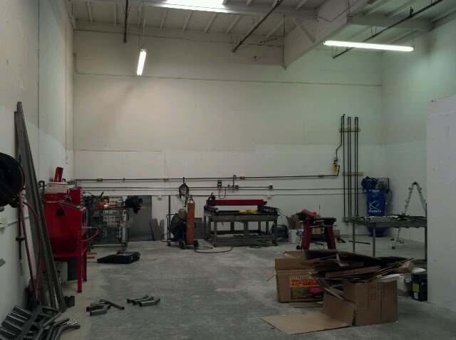

    Well the set up is going good I got all my air lines up and started putting things away. I should be up and running again by the end of the week. :D
    The TorchMate should be good to go by tomorrow.

    That compressor is gonna be loud in there?

    Your cutting table looks crooked, who the hell leveled the thing? Was he drunk???:D

    nice dude, we need to get you some posters in there. 5.1 surround sound?

    Between the compressor and everything else going on, it's gonna be too noisy for a radio

    this compressor is way better than the smaller one, quieter, charges faster, and holds way more air. jerry would die with out his COUNTRY MUSIC!

    Looks good Jerry! I guess the compressor is bolted to the floor now?

    it needs a buffer, it cant be ridged because the compressor will vibrate it self to pieces

    Yeah. Remember I was asking about the vibration pads and anchors? Normally, you set the compressor on the pads and use a fairly long concrete anchor to secure it to the floor. The bolts are left loose to keep the thing from vibrating to pieces.

    Oh it's a 2 stage it's super quite :cool:
    Yeah I bolted it down yesterday I left the bolts loose for vibrations. The thing I was going on about was the air piping I added just under 2gal volume with all the pipe i used and 53' of cooling pipe before the first filter.
