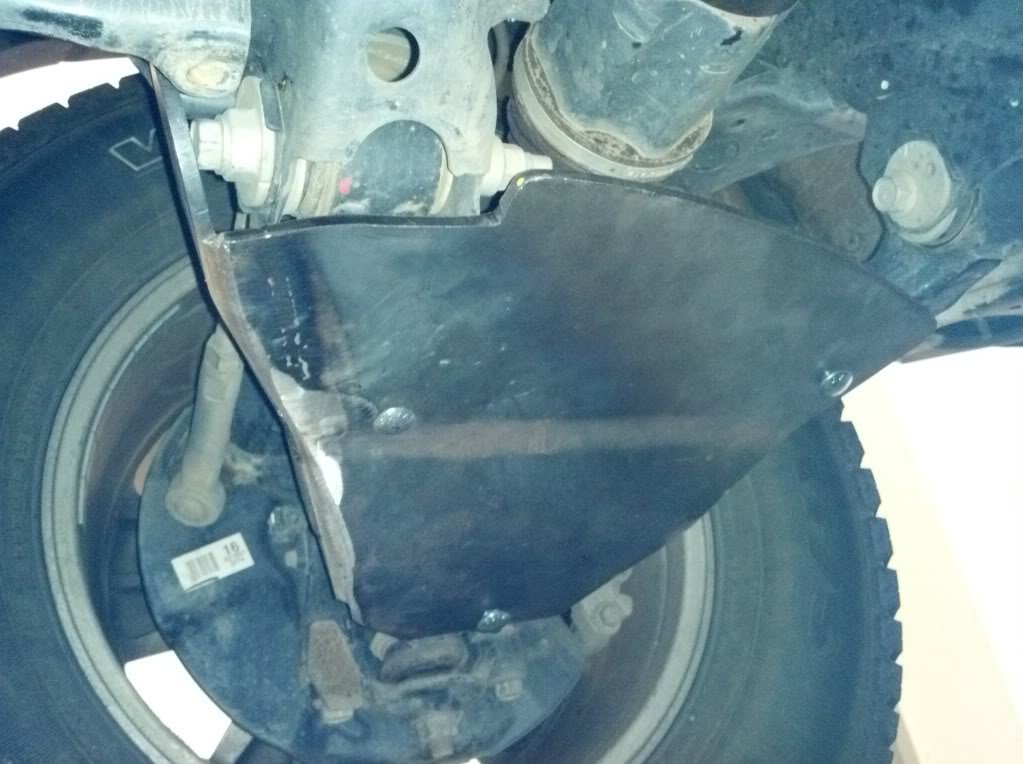

    Jerry,
    Here is a shot of my LCA - I have the BudBuilt Skid setup and as you can see the cam bolt is covered by the skid...
    There is clearance between them, I'd just like to know how far away from the cam bolt your LCA Skid sits...

    Oh I didn't know the BB had coverage take a shot from right under the cam bolt. The skid sits right next to the cam bolt so if you have a 1 or so clearance it should fit right behind the BB skid.

    I just went back to the OP & I think there will be no issues...
    Looking at this:
    The skid sits pretty tight to the cam - I've got at least 1 1/2" between the IFS skid & the cam.
    We'll see... I've got no issues cutting to make it fit. :cool:

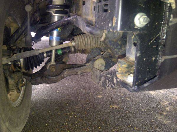

    Here is my LCA, although I'm not sure why it flips it upside down....

    Looks the same as mine
