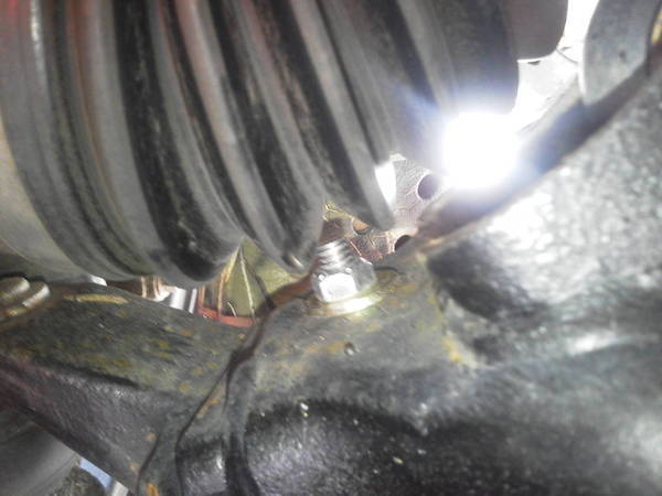

    i'm assuming the long inner bolt was just for test purposes, but if the outer bolt by the ball joint was not just for test fitting, you will most likely need a shorter one for any truck with extended travel fronts.
    the bolt on mine is shorter than what's pictured, and just clears the CV boot by less than the thickness of a penny at full drop. just a heads up.

    You are correct, those bolts were test ones, the one under the CV is a three incher, it's going to be replaced by a 2 1/2 and the top ones will be the right height as well, I shoot some pics showing this when I put them back on.

    Yeah those were just mock up bolts i had sitting around the shop the kit will have four 3.5" and two 2.5" bolts nuts and washers.

    fantastic. would just hate for you to go and tear a boot on the first run :thumbsup:

    Yeah that was the first thing I noticed when mocking up.
