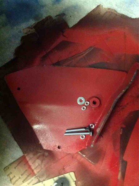

    I just put mine on, but had to take them off. They rub on my Relentless IFS skid. No biggie, ill just have to trim them, then reinstall. Just letting those who have Relentless skids to check it out too.

    Anyone running the Relentless IFS know? I figured there would be some trimming involved... if the stock junk needs to the trimmed!

    Im actually going to trim the LCA skids, not the skidplates. Im going to take about a half inch off of the "jutted out" part on the wider side.

    Yeah I forgot all about that we found that out in MOAB the LCA skid comes in contact with the passenger side just sitting on the ground and touches a little on the driver side at full droop. i don't know why it's different for each side but the trimming is minimal.

    My passenger side skids looks like this now: ImageUploadedByTapatalk1338251885.874012.jpg Notice no cutout on the radius side and will need some more trimming on the radius and maybe on the alignment cam cover.
    Jerry-Am I good to keep cutting/grinding until they fit?? Once I get more cutting wheels and a new grinding disc that is...I don't want to compromise anything about the skids by cutting too much outta them.

    Man you needed to cut that much for it to fit on the passenger side? you really can cut as much as you want as long as all three bolts are still there they will stay in place.
    So far only the Relentless skids are causing this i know there was a little on the Bud Built that Homer had to trim but nothing like that.

    And yeah-that much just let me get the bottom bolt all the way into position. Gunna have to trim a little bit more and then see how the droop works out. No worries-Custom stuff takes some extra work. I'll probably not get to the for a while-Got some stuff coming up.

    Yeah it's odd that the Relentless skid is so far over towards the passenger side I guess it has the most coverage for you guys because most of the others have inches of clearance right there.
