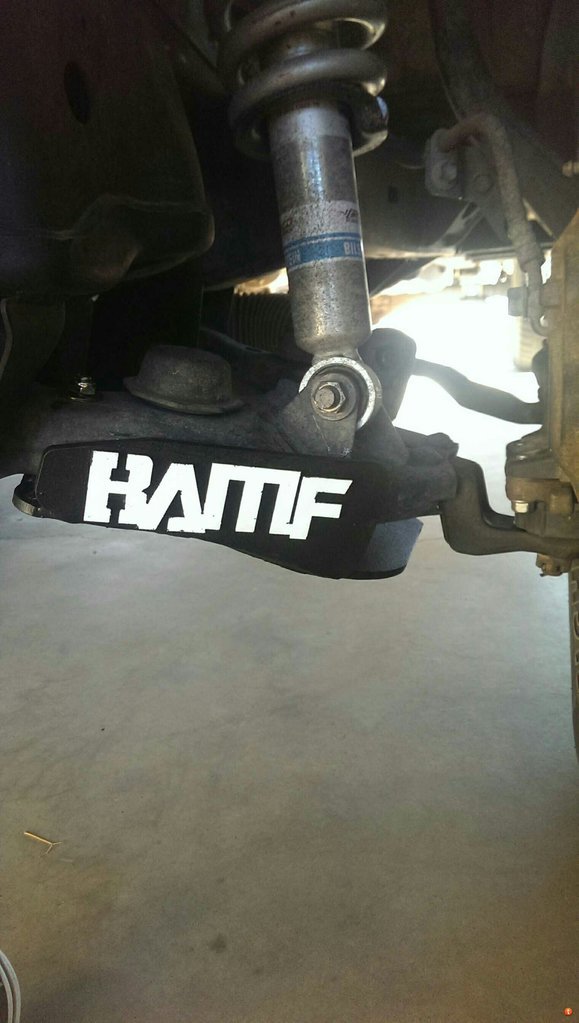

    Peep the build
    So just got mine in and they pretty much line up with existing holes on the lca.. Is that we're they go? eqebady9_a7860edeabeb25468853806ec3aefc18e20641f2.jpg
    I feel like I'm missing something here?

    There is only one way for each one to be installed on the LCA, and you can't swap left and right. Looks correct from the pic. BAMF forward so the skids can see what's coming and you can't really screw these up.

    Yeah I've got the top two bolts in just fine.. I just find it weird that I didn't have to drill at all to get these on.. The holes are already 3/8ths?

    Is just the bottom right one where those 3 rivet things are holding on the lbj

    Those are bolts with the nuts on the bottom. Make sure you get the third bolt in each one of the LCA skids. If you don't, you risk tearing it off while wheeling, and possibly ruin the LCA

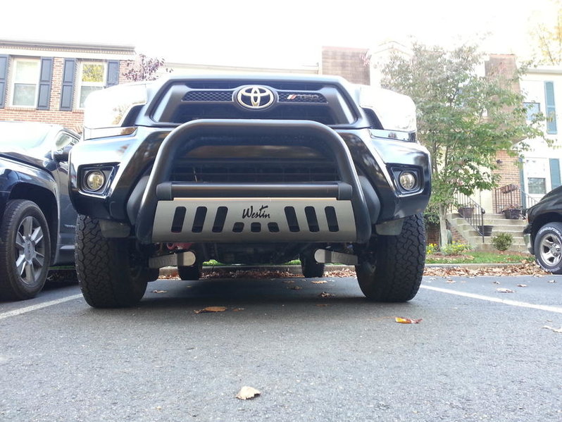

    LCA skids fit with RCI skid plate. thanks for the sale Jerry!

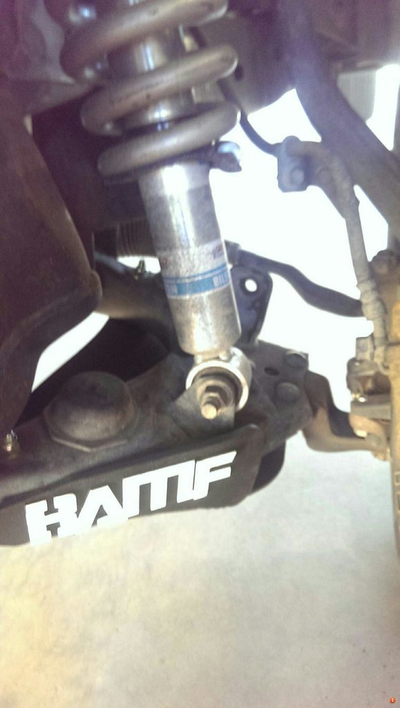

    Installed mine today. Had to widen the rear bolt hole (one behind "BAMF")a tad but they fit great other than that.
