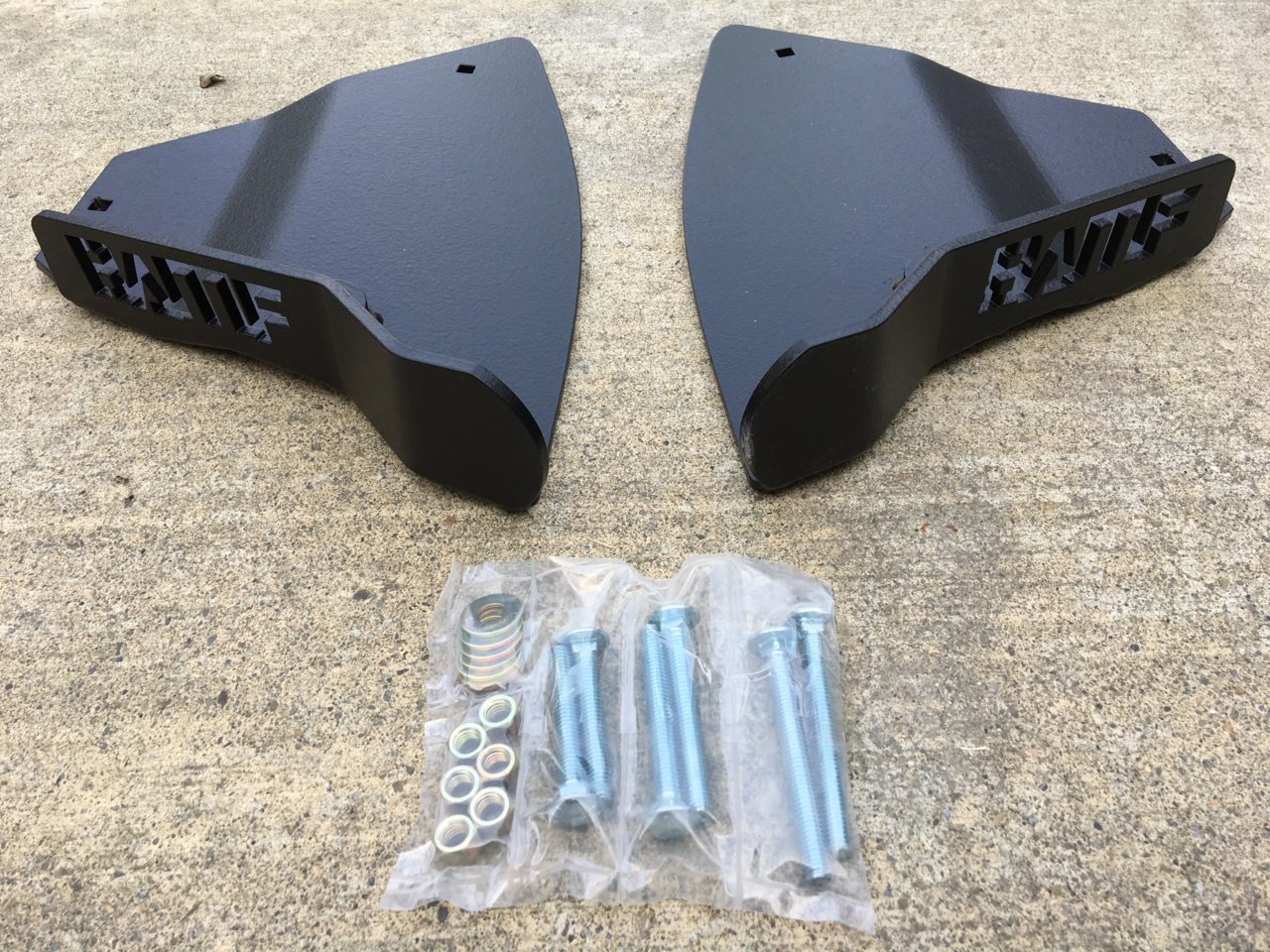

    Jerry, can you throw up a current shot of what the LCA skid looks like? I've read there has been a new design, just can't seem to find an image/not sure what the new vs old would be. Thanks.

    Just got 'em for 2nd gen. Awesome quality and customer service. Honored a order cancellation and put in a new order to save a couple of bucks. Quick to install. You should use a step drill bit on the hole closest to the lower ball joint for the cleanest hole. Spray paint the freshly exposed metal. Install the short carriage bolt near the lower ball joint (need to use open ended wrench due to CV axle interference), middle sized carriage bolt in front, longest carriage bolt toward the rear.

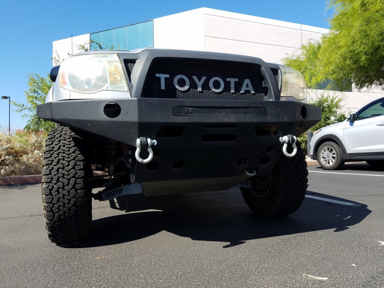

    Whoops, these have been on my truck since June...
    Crappy lighting but you can see them on there!

    Haha thanks man. Glad I posted that all those months ago for someone to come along.
