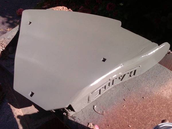

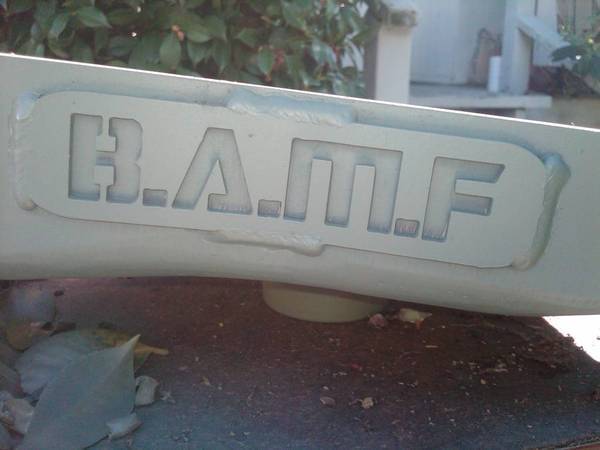

    Been a busy week, finally getting to these!
    After an acetone rubdown and scoring with heavy sandpaper, time for the self-etching primer

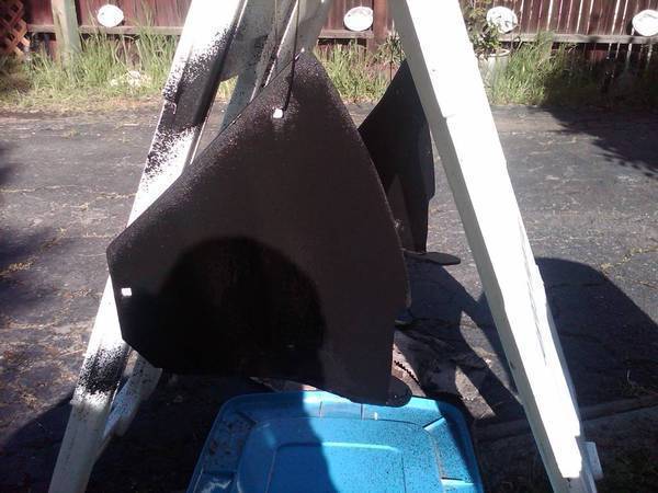

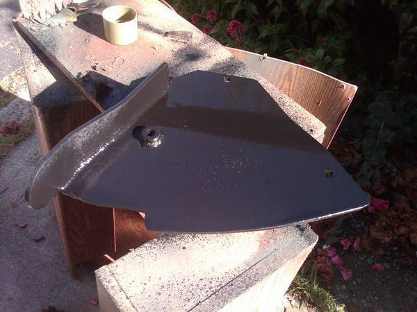

    ...and on to the truck-bed coating...
    couple of coat hangers (No more wire coat hangers!!!! AAAHAHHHHH!) who got that reference?
    anyhow, three coats should do
