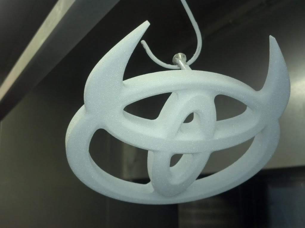

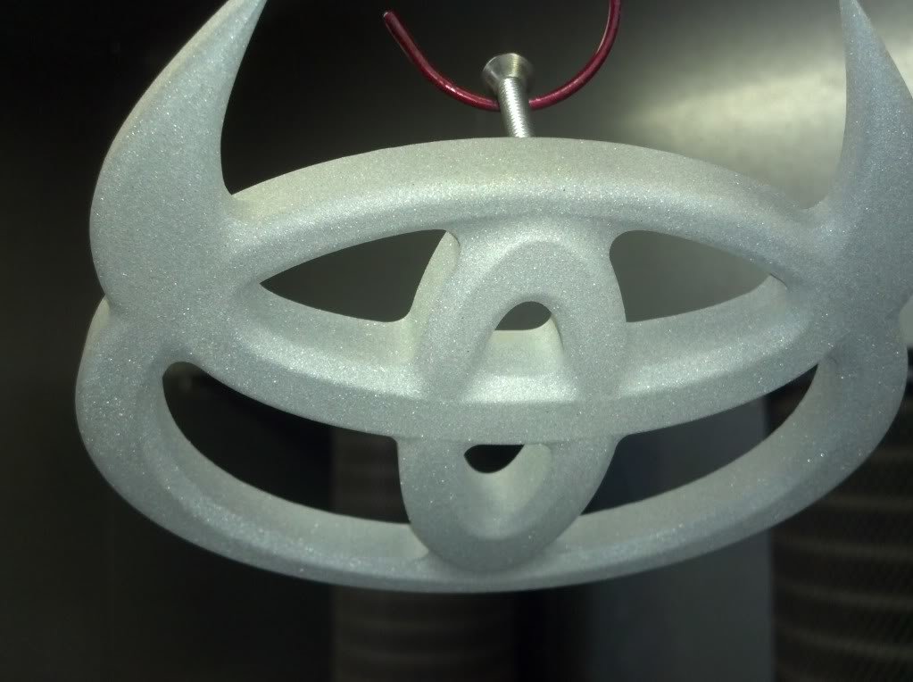

    I did a little restore on some devil horns for a member :cool:
    Before the clear had chipped away and yellowed over time.
    Blasted with a 30/40 Garnet to remove the tool marks and clear coating
    Shot with silver powder pre bake
    Fully cured

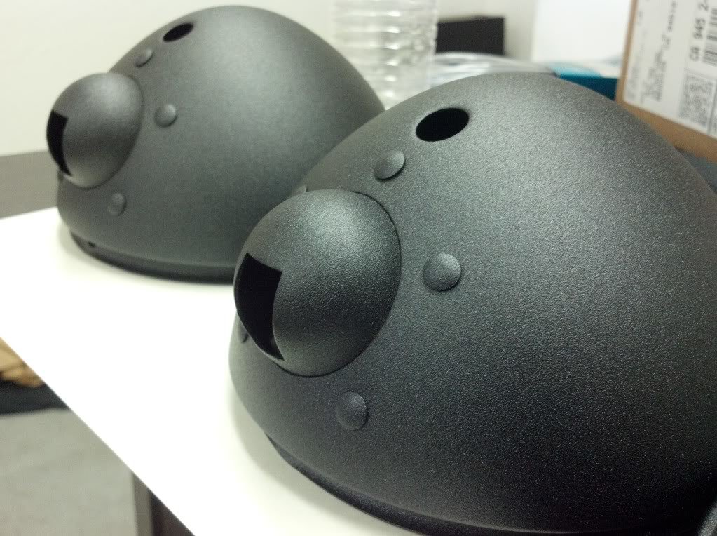

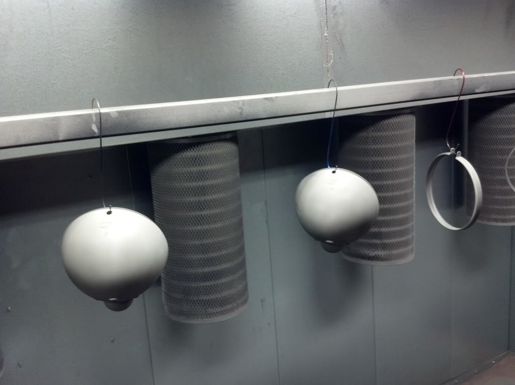

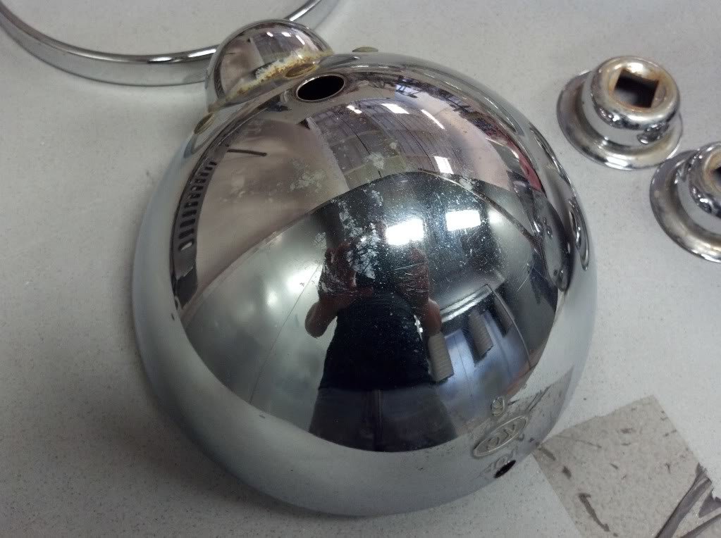

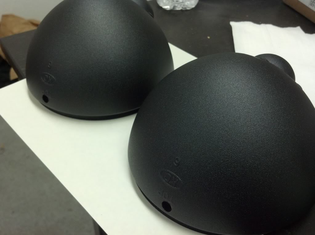

    I did a KC light restoration for acdronin.
    They came in all rusty and chrome but for the most part in good shape.
    Shot with 30/40 Garnet
    Powdered and cured with the Black coal powder i use on all me products :cool:

    The finish looks awesome Jerry! Can't wait to mount these puppies!
