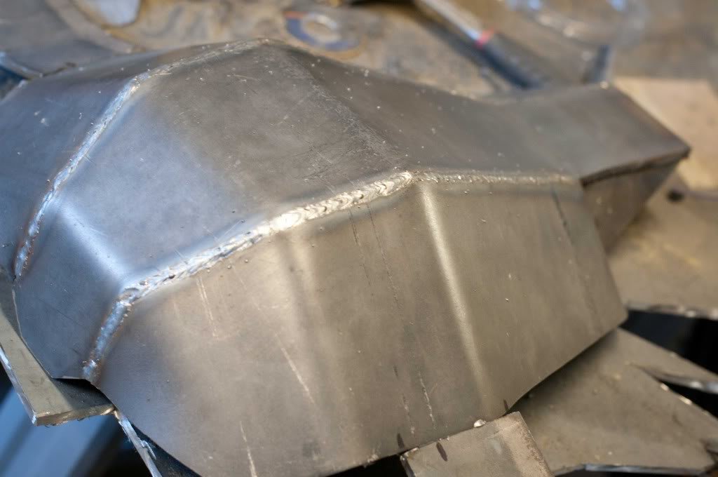

    so its mounted on the sides of the axel with u-bolts, is that the only places its mounted? what about the front of the diff?

    The mounting points are not welded on yet I ran out of light last night. it will be mounted tomorrow or the next day and I need to run and pick up some U-bolts for the axle mounts.

    I've just been making some that will fit in my bender angle for little tabs and brackets with 1/4" angle and I made some ball joint presses. the only thing I bought was the DIY plate bender kit from Swagoffroad.com Troy makes some great stuff.

    The skid shell is three different sheets of 1/4" plate bent into shape and welded into one. And to get the shape I did it the old school way and mocked it up with cardboard taped together one piece at a time and transferred the template to the steel "cardboard is more forgiving then steel :D"
