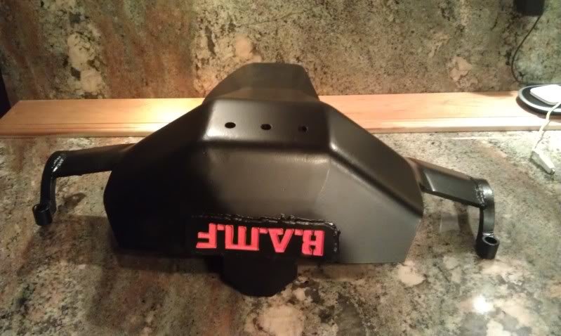

    Sweet! I was going to do the same, but once I got it I had to go all red with black lettering...:cool:
    Pics to come soon...:D

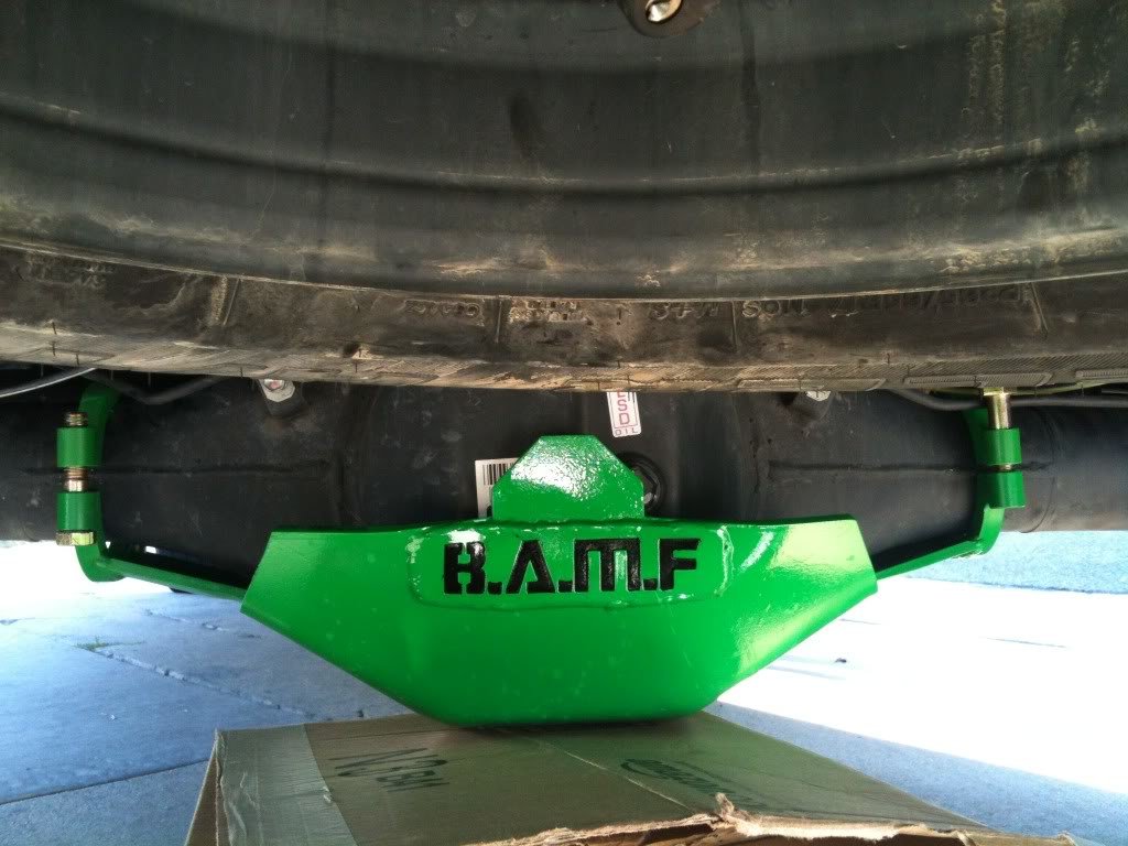

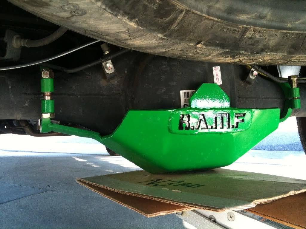

    Cool. Funny thing is it is actually florescent orange but you just cannot make that pop with a cell phone pic.

    Thanks, but you built it... I only painted it... :eek:
    I did not notice until I was cutting out the masking tape around the logo - you do not have a period after the "F" in B.A.M.F
    I suppose if you did do that with the font you use it would look like B.A.M.E
    Right? :rolleyes:

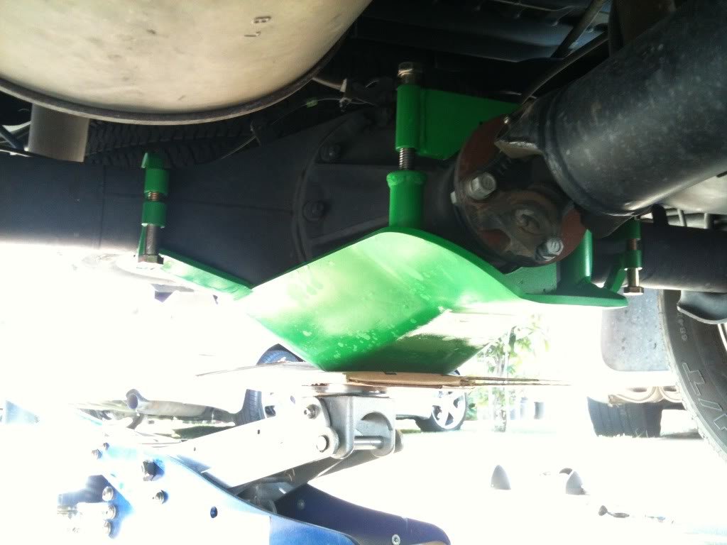

    Got a chance to try mines out today, having some fitment issues.
    Anyone know what I may be doing wrong? I did quite a bit of moving around and can't get it to fit right.

    Is it the axle clamp bolts not going in? those are side specific also it looks like your axle weld might be getting in the way of the axle clamp you can sand the axle clamp to fit around that weld I grind them down a little to compensate for that but they are all different. It is a very tight fit and the axle clamps will not fit flush unless it clears that weld.
    If you can't get it shoot me a PM I will help you get it installed.

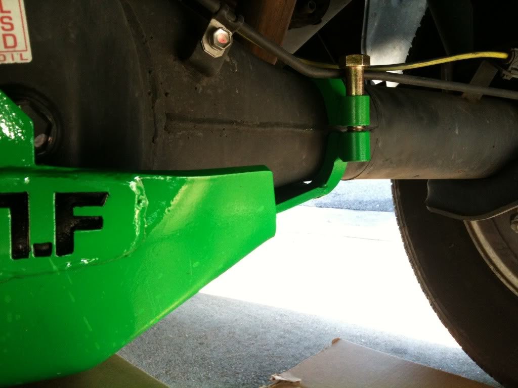

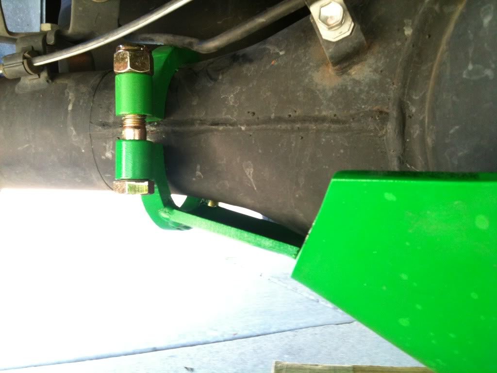

    Okay so i went out and checked some skids here is a shot of the skid threading one side in. I won't fit by threading just one side in first
    And the same skid threading both at the same time I know the fitment is tight but it should fit.

    Yeah the tolerances are tight but if I made them loose it wouldn't fit snug the weld on the axle is out of my hands it's different on every truck I've installed it on. Some went right around it ans some I had to do a little more grinding on for them to fit snug.
    I HIGHLY recommend test fitting your skid before painting it slight modifications may need to be made to it for fitment.
