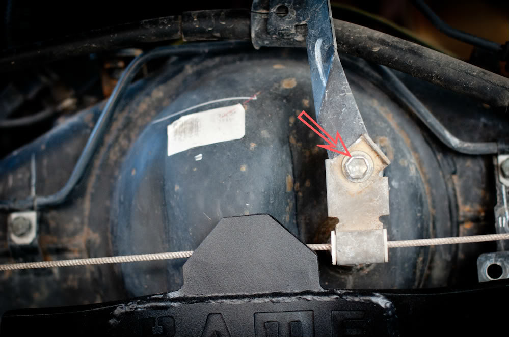

    Did you do anything about the parking brake line yet?

    Nothing needs be done all you need to do is remove the 12mm bolt holding that bracket on and flip it up to the bracket above it. I'll post a picture later today.

    That's all that needs to be done is move it here :cool:

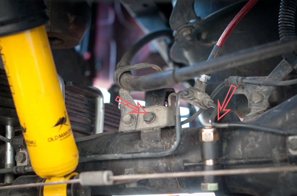

    Also remove the hard line bracket to mount the skid and then you can move the hard line up a little so it clears the brake line.
