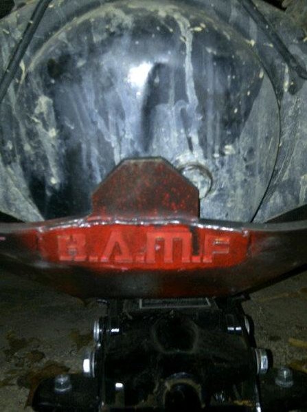

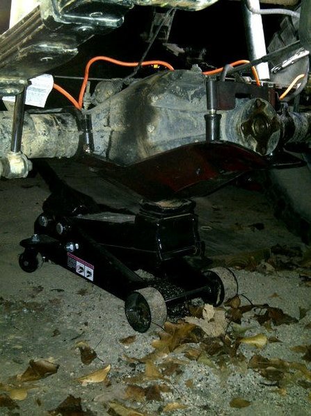

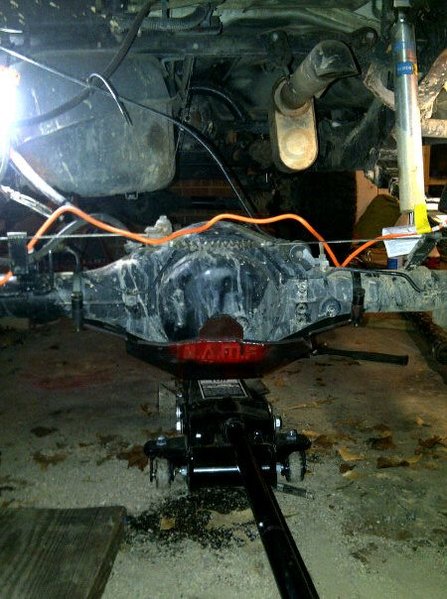

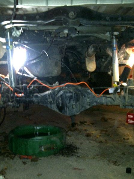

    love it, pics tomorrow, but i really hope i never ever hafta remove it on the trails lol

    You didn't have to remove the driveshaft to install it :p

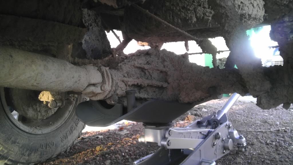

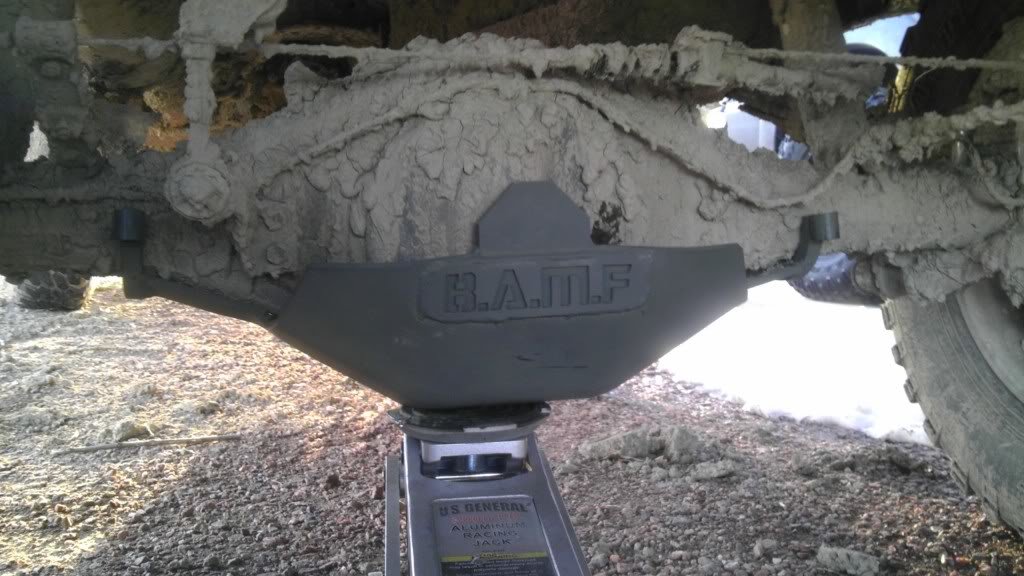

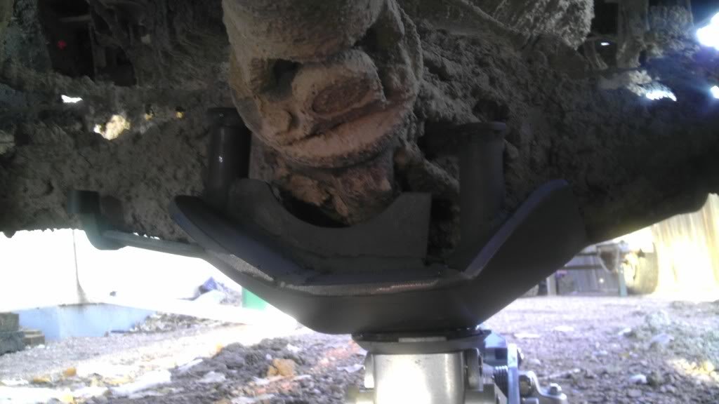

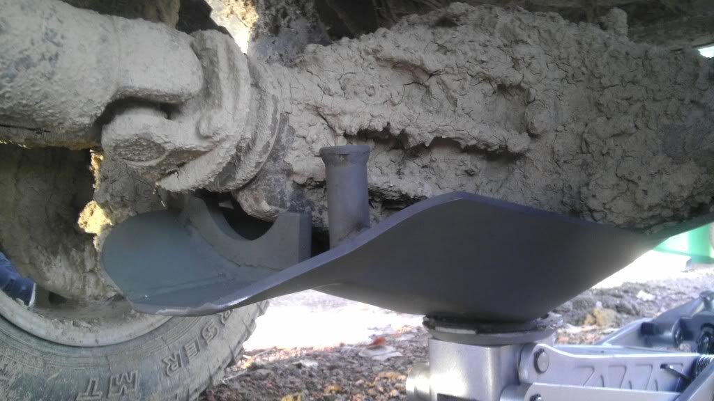

    The third member is completely different on the '82. The axle is a good fit though. Guys with elockers could run em probably. Just need to make a couple minor mount changes on the front mount and it'll probably work. I'm not sure what the v6 or third gen (ifs rear axle) thirds look like. I didn't even bother trying the front. With the spring perch right next to the pumpkin you'll need a new design.

    and i thought my shit was messy!

    I had some fun the other day! Haven't had time to bust out the power washer yet. I need to its pretty bad huh!
