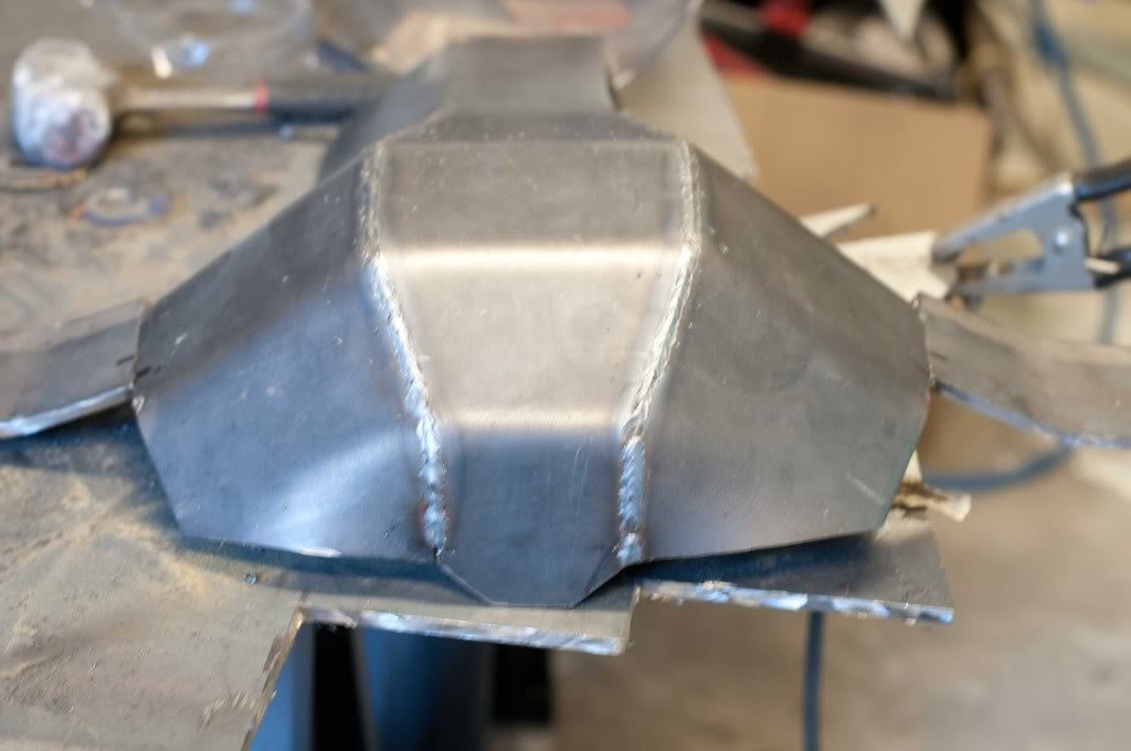

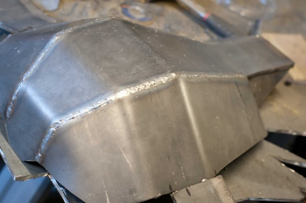

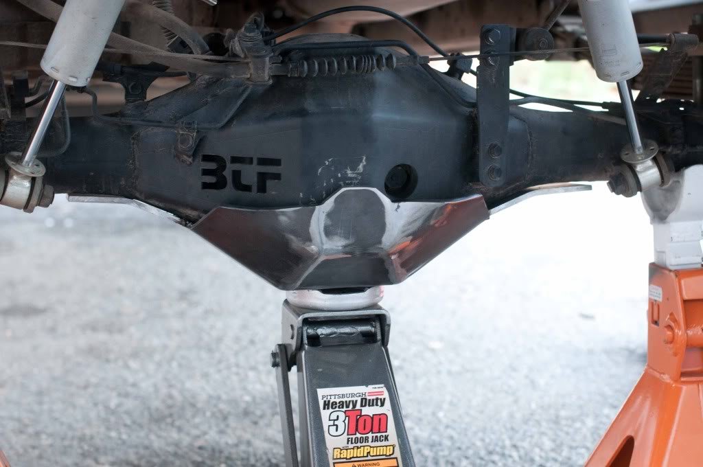

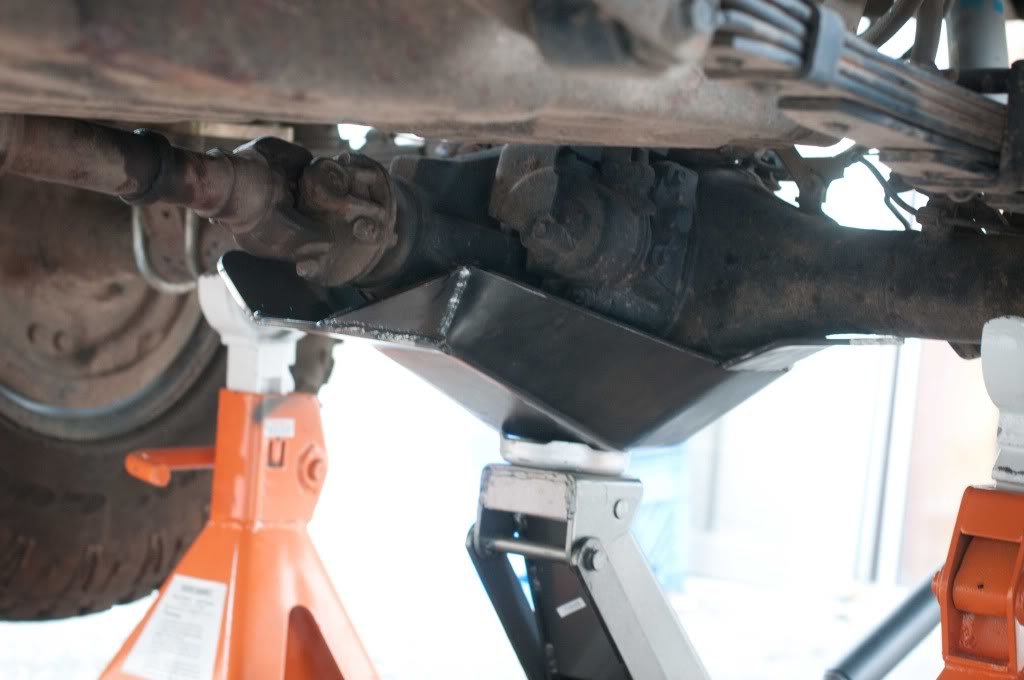

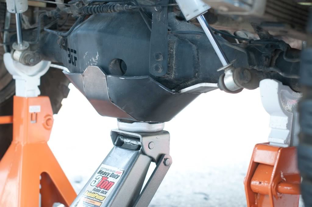

    I built the prototype shell today and let me say it came out awesome. Here are a few shots of the skid without the mounting hardware the mounts are going to be U-bolts on the axle and 3/4"DOM tubing with welded a nut to thread a top plate at the pinion on I should have the top plate done tomorrow.
    All Tacked up
    Fully welded
    Another big Update :eek:

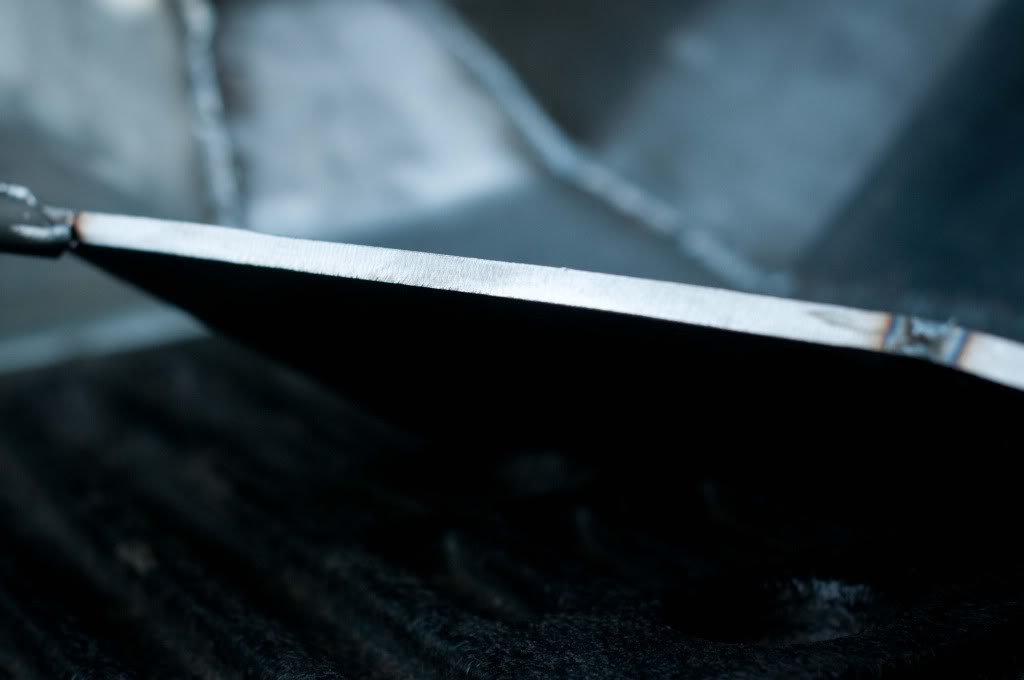

    After cutting the skid out by hand and seeing how good the cuts were I've decided to offer you guys a hand cut skid instead of CNC cut for $225.00+ shipping. I will only offer this if everyone wants it I'm not going to do some CNC cut and some cut by hand. So that will be a option to save a little more money.
    Here is a shot of the hand cut edges
