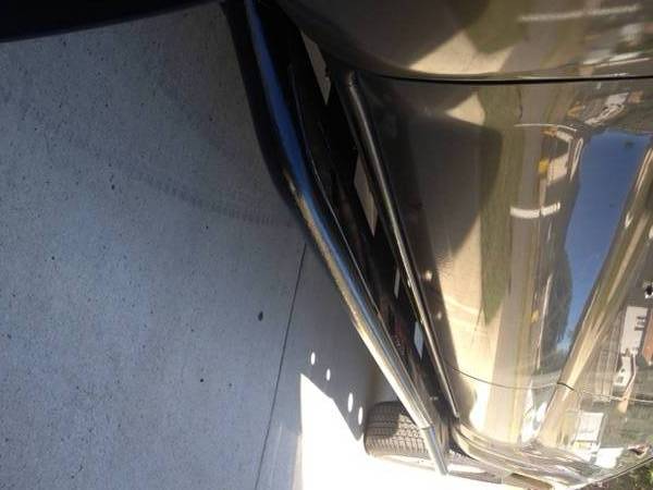

    Just installed drivers side yesterday. Did anyone have any problems in the front with the knife edge digging into the slider? I had to pick up a pizza when I was done, it was knocking when when I went over bumps.

    Installed drivers side bolt on yesterday (DCLB). Under the driver's side door, the knife edge is digging into the slider and knocking when I hit bumps.

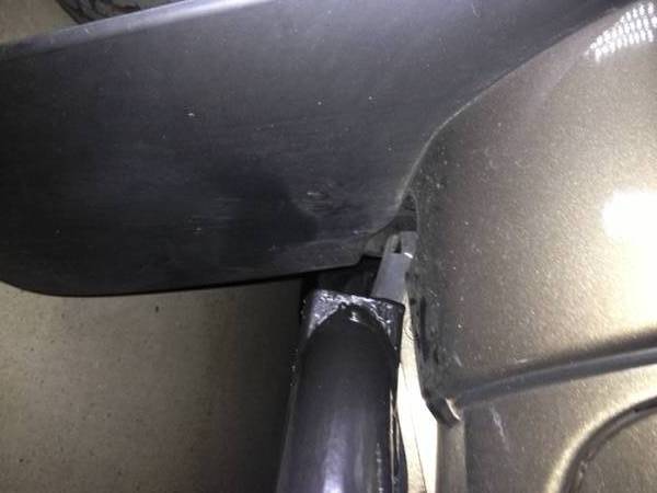

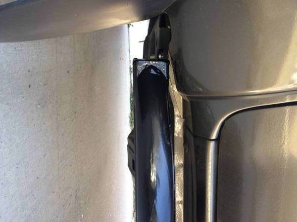

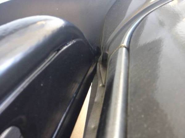

    My passenger side looks like this. It makes contact with the truck when I jack from the slider. I'm going to shoot him a message because I can't have the slider making contact with the truck when I jack from it, let alone if I came down on a rock.

    Jerry,
    My passenger slider makes contact with the cab when jacked. It sits about 1/2" higher than the driver slider and about 1/2" more forward. This has to be fixed. I cannot jack the passenger side without it making contact with the cab, which also means it cannot land on a rock without doing the same.
    Passenger Front (Not Jacked)
    Passenger Front Jacked
    Driver Front (Not Jacked)
    Passenger Rear (Not Jacked)
    Passenger Rear Jacked
    Driver Rear (Not Jacked)
    I'll PM you so that we can work out how this is going to get fixed.

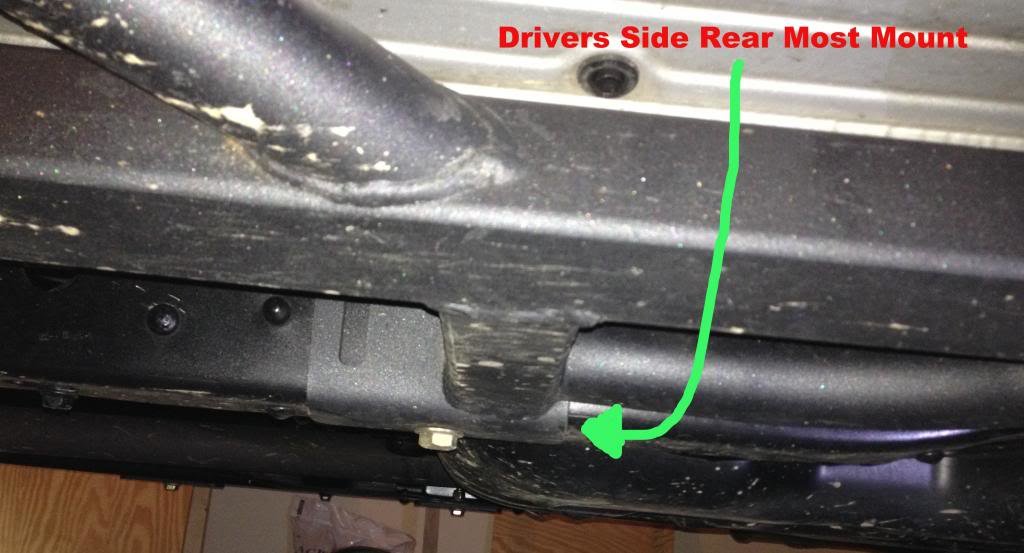

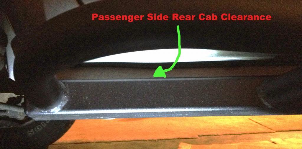

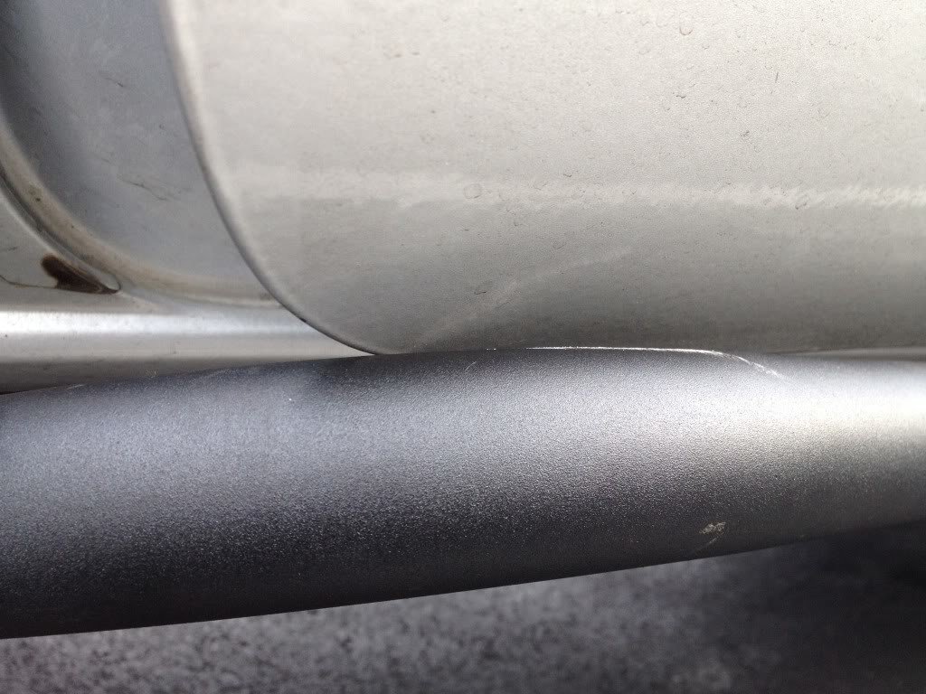

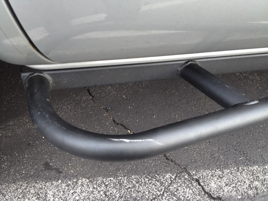

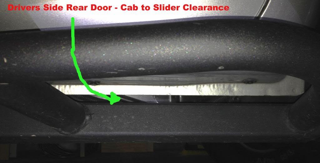

    I finally after months finished drilling and bolting on my passenger side sliders, and went to open the rear door on my DCSB, to have this happen... major interference. Had to force the door closed, and used some touch up paint to over the impact.
    Then I started looking at my install and the difference between the drivers side (which is perfect) and the passenger side.
    Driver side rear most frame mount:
    And then the passenger side:
    And then I found the issue, or alteast what I think is the issue, compare this picture to the one above from the drivers side, and see where the slider mounts are welded to the frame bolting plate, see how the passenger side is so much higher. This is causing the rear of the sliders to be so much higher and interfere with the door.
    I have a Double Cab Short Bed, 2nd Gen, and these are Bolt On Sliders with the Kick Out.
    Jerry I sent you an email last weekend, and I will PM you here too now. Just wanted to share this with everyone, and see if anyone else has had this issue, and if there were recommendations that didnt involve re-welding them, since I dont know how to weld nor do I own a welder.
    On a side note, I wanted to check the front and rear door clearance with the weight of the truck on the sliders, and the front doors are no issue, but the back door on my drivers side interferes with the sliders when they are supporting my truck. Not a surprise at all. But something to note if I have to use my rear doors for some reason when I am stuck on something, since I keep some of my recovery gear back there. But I bet even with welded on sliders this is the case.
    What should we torque the mounting bolts too? I think I did 85 ft-lbs, like lug nuts.

    Michael I replied to your email 7 day's ago and you never responded. PM incoming
  19. Oct 14, 2013 at 1:27 PM
    #1679
    goufcustom
    goufcustom 7.62x63mm
    Oct 3, 2011
    #64586
    1,321
    MD
    2021 4x4 TRD Sport DCLB
    Thanks Jerry.
    I got the spacer kit, will be installing it today.
