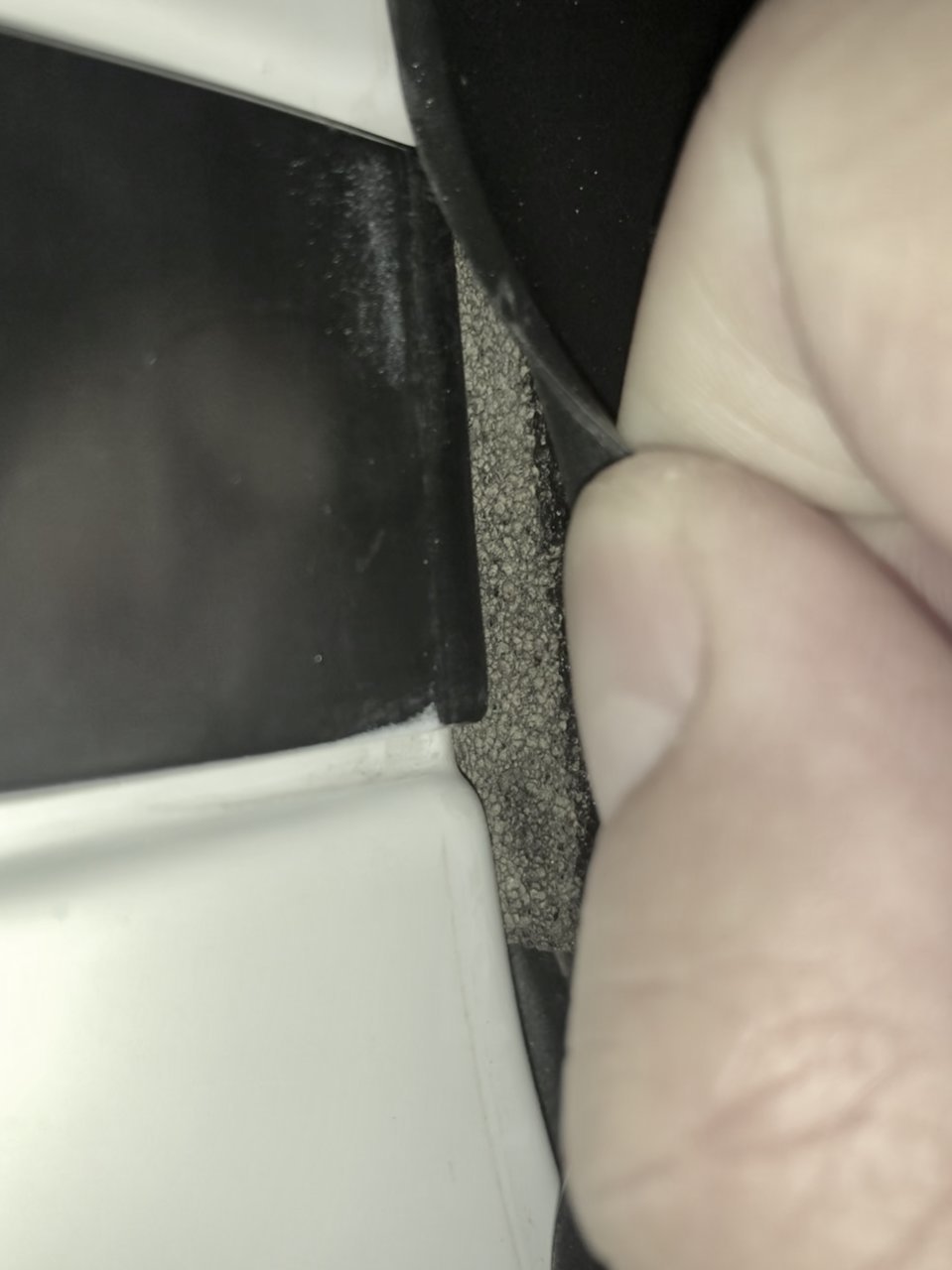

    So I’m experiencing some issues too. Pulled off the OEM roof rack and sealed up the holes. Our back the standard moldings and still leaking from the rear but not from the third brake light. Haven’t tried the hose test since I thought this would’vs fixed it. Did yours leak on the left and right rear window where the roof moldings meet the rear window?

    Where are you noticing water collecting?

    Just a little damp on the headliner on each side, the middle completely dry. I can reach inside the headliner and feel the wetness too. Noticed behind the outside of the molding that there’s foam there.

    I put a little bit of silicone but not too much since I’m planning on a Prinsu. But I did put weatherproof Gorilla tape over it too and it’s really secured in there. I really think where the rear window molding and roof molding meets is where the leak is at. I pulled the rear molding to see the inside and it was just glass and a piece of foam about 2” wide then the rubber seal

    Huh, it could possibly be not enough silicone up there. Not really sure where else it could originate from besides that 3rd brake light.

    100% positive that it’s not coming from the bolt holes. I think it’s either rear window seal or third brake light but seeing if you discovered yours. Check out the foam piece I’m talking about when I move the rear window seal.
