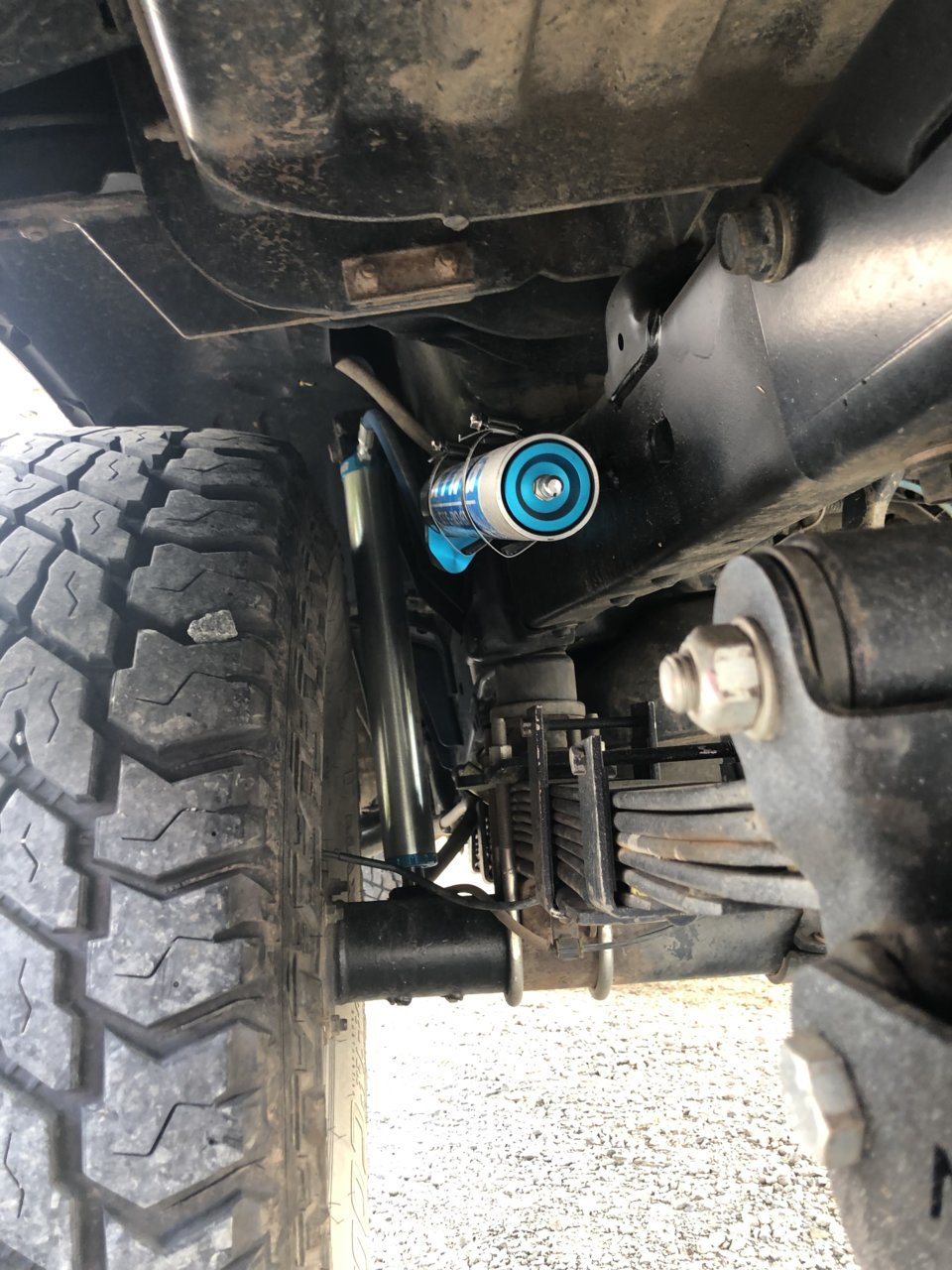

    I have Dakar heavies, B110s and super bumps with the 3/8” spacer and it’s enough to keep the shock from bottoming out but just barely.

    I would guess you will need a little more to keep the shock from bottoming out at full compression. My setup that was s is a single AAL with a 1” block and I have about between .25” and .5” of a safety net before the shock bottoms out.
    (Picture was taken before I put the 110s on)

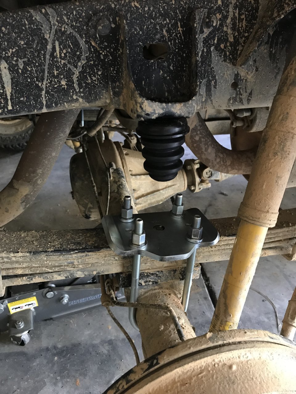

    These are Dakar heavies with the extra AAL, and super bumps with Wheelers ubolt flip.

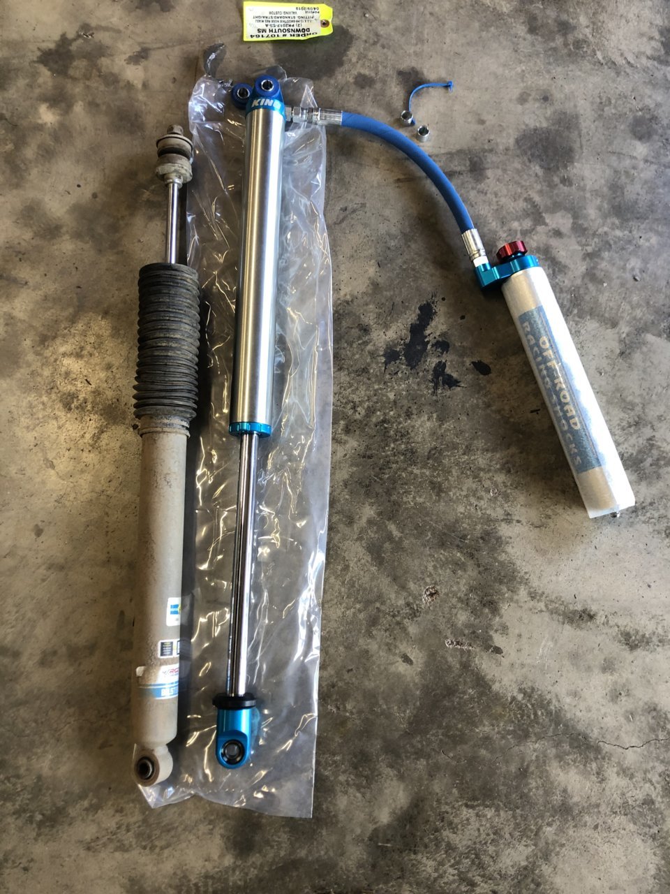

    I just took my B110s off to replace with King 12"

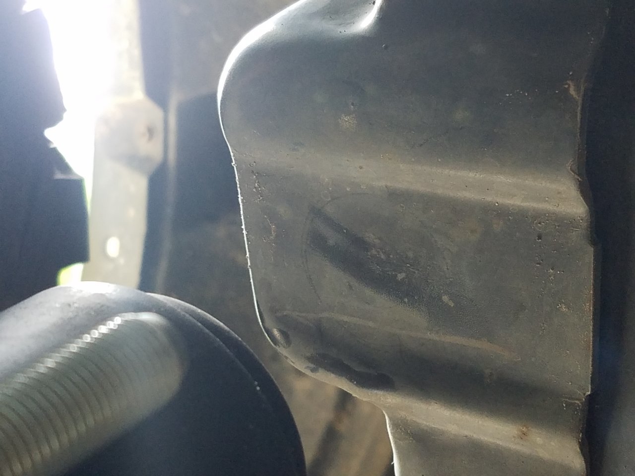

    Under my truck retorqueing and looked at the underside of where the bumpstop would contact. Looks like it's barely touched. If you look closely, you can see small ring marks left by the bumpstop. I'll take this as a good indication of where I am but will add a bumpstop spacer to be on the safe side.

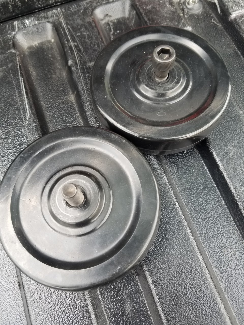

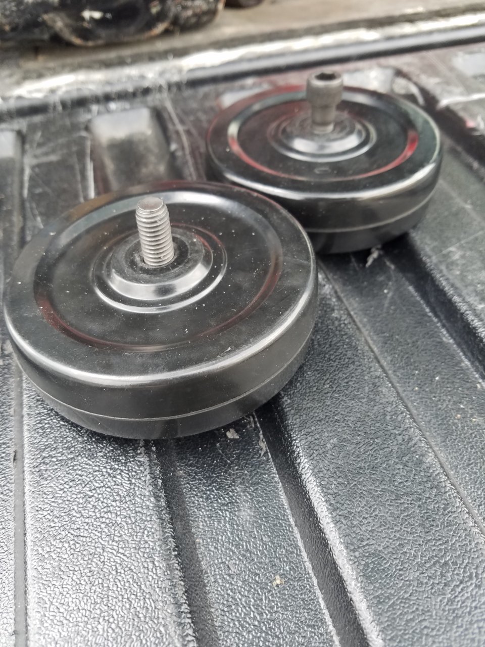

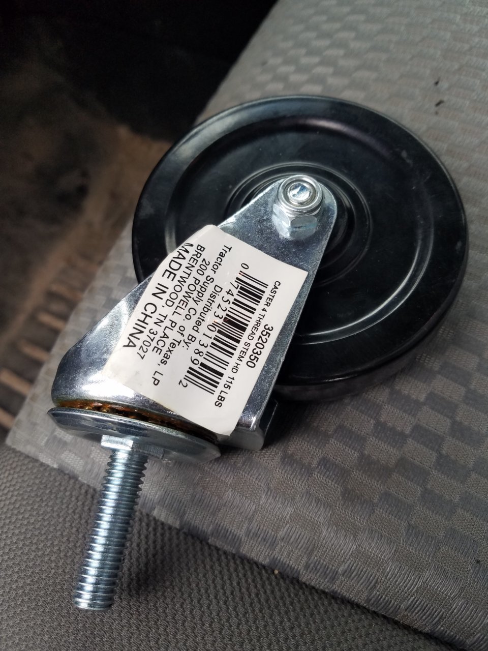

    So I went to TSC with an idea.
    3/8"-16X 2.5" SHCS Bolts (1.49/ea)
    4" solid rubber caster wheels (9.99/ea)
    Had to drill out the hole for the bolt to fit but at just under $25 these should work. They are just over an inch thick.
