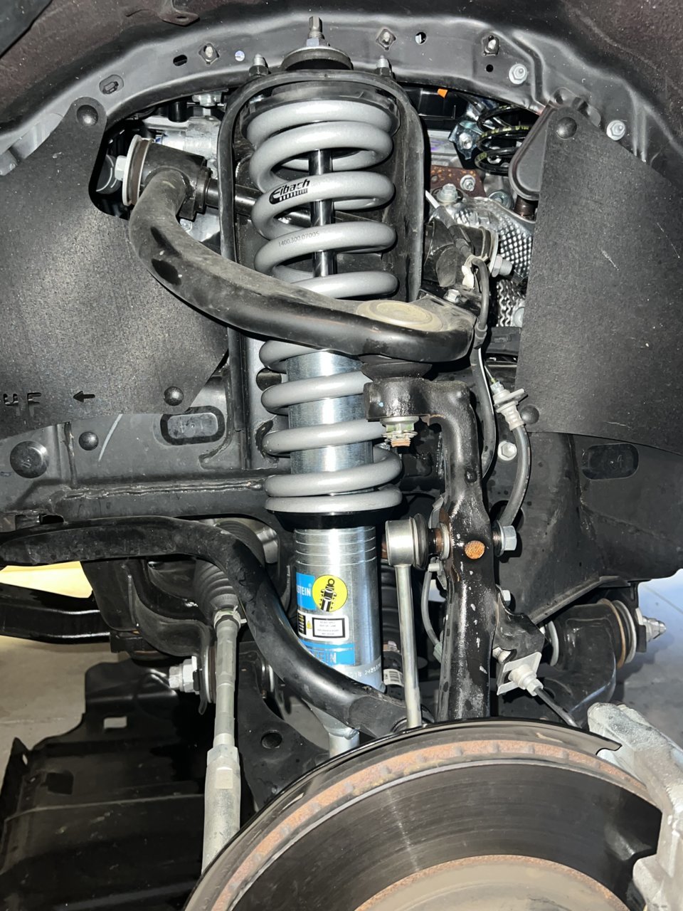

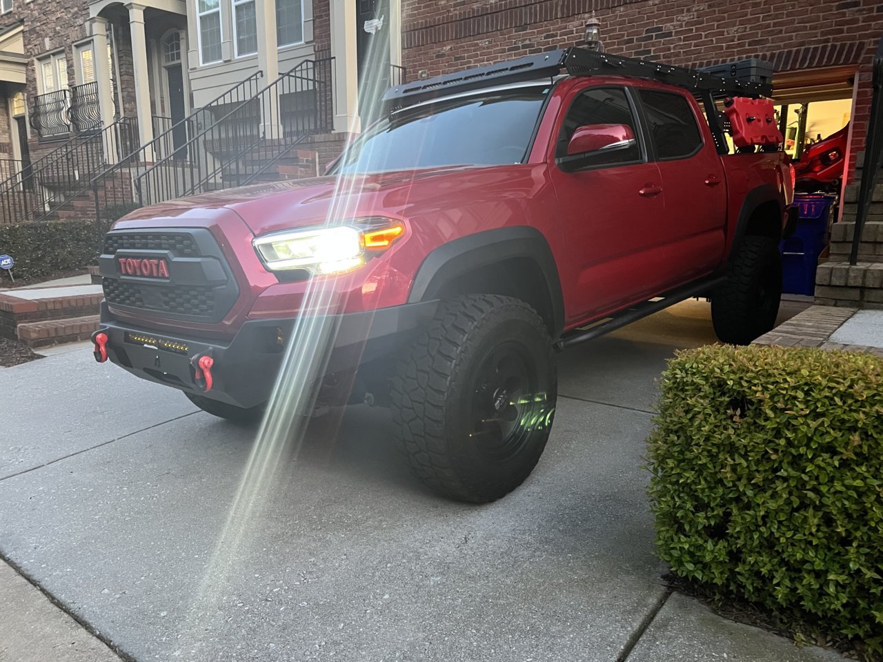

    Installed 6112’s tonight on my ‘21 TRDOR and thought I’d share. Followed the Shock Surplus tutorial on YouTube. Thank goodness for that. Ordered with Eibach 700# springs on 5/4.

    Thanks 6 weeks now and still have 10 nerve pain. Blood clots in my lungs are gone. Clay, your truck is beautiful. I looked for that color but they are very hard to find. Can’t wait to go to the sand dunes and try out these shocks. Less power on this truck , no supercharger like my last taco.

    I see you are on the 5th ring on the shocks and wondered how many inches that raised your truck.

    Got 1” over factory. 23” over center of the cap.

    I was expecting the worst after reading so many posts on TW about 5”+ on the top notch. Especially with the 700# Eibach springs. I’m sure the weight of the steel bumper, the rock sliders, and the roof rack keep it down a bit… but hard to say and that’s all speculation.
    I ended up with higher lift in the back from the Stage 3 Deaver leafs than I have in the front on the 5/4 circlips.
