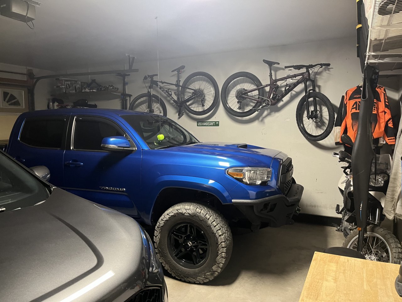

    Nice stance Bart45 the instruction said no higher than four on the right and five on the left . Its now 1/4 inch higher on the left. I well let it settle down and check it again.

    Lookin good, man.
