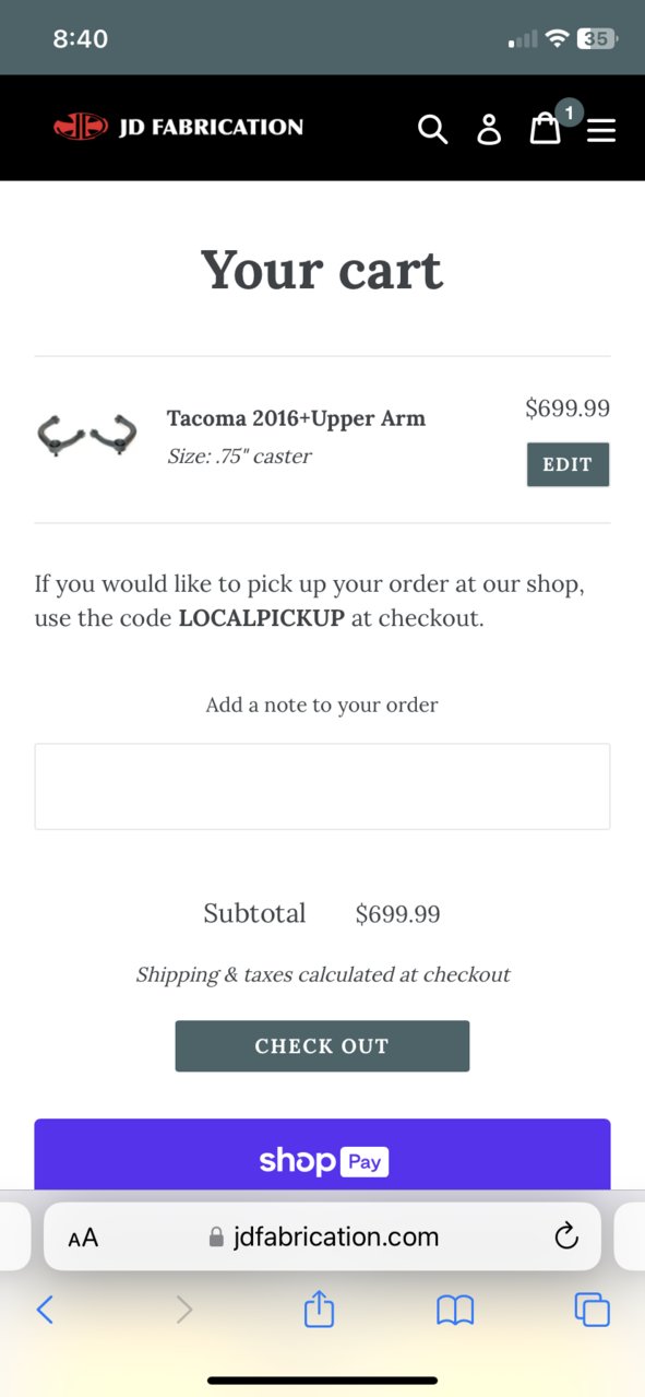

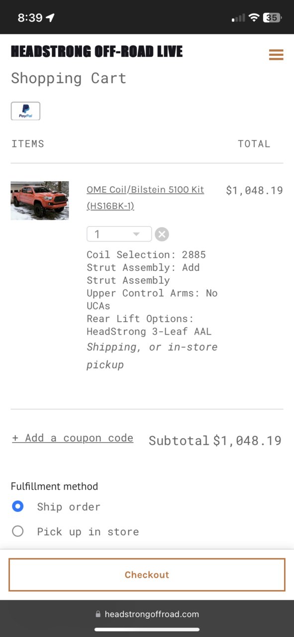

    How will this work out ?
    what specs would you run (front lift amount etc ) on a DCLB 4x4 to start out with.
    still looking around thanks

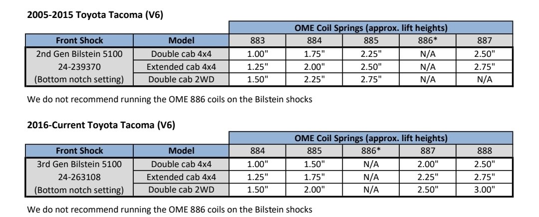

    This should provide some guidance for you. Good setup overall with a lot of guys running that combo.

    Totally up to you on lift amount. And that kinda depends on what you're looking for in terms of looks and performance.
    I'd seriously consider the 6112/5160 shocks though. Assuming you're not going for too big of a lift I'd skip the UCA's and that'd free up your budget to afford the better shocks. Often, with a smaller lift amount you don't need the alignment changes aftermarket UCA's give you and they can even increase your rubbing issues. There are tons of factors here so sorta hard to predict without a lot more info.
