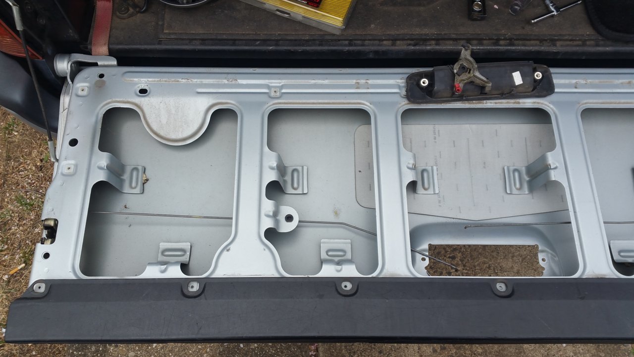

    Anyone here install a backup camera into an older Tacoma? I just down/up graded (depending on how you look at it) from a 2010 prerunner to a 2007 tacoma SR5 4x4. It has a bed cap on it and I’m really starting to miss my back up camera. Amazon has a back up camera on sale that replaces the tail gate handle. Just looking to see if someone has done this and what Head unit upgrade you used. Thanks

    got a link on the back up camera handle? id live to swap out my oem one for a camera one and maybe with locking capability... if nothing else, cleaner than adding one mounted to license plate.

    thanks! are you trying to run to a double din unit? or have you considered a rear view mirror back up camera screen?

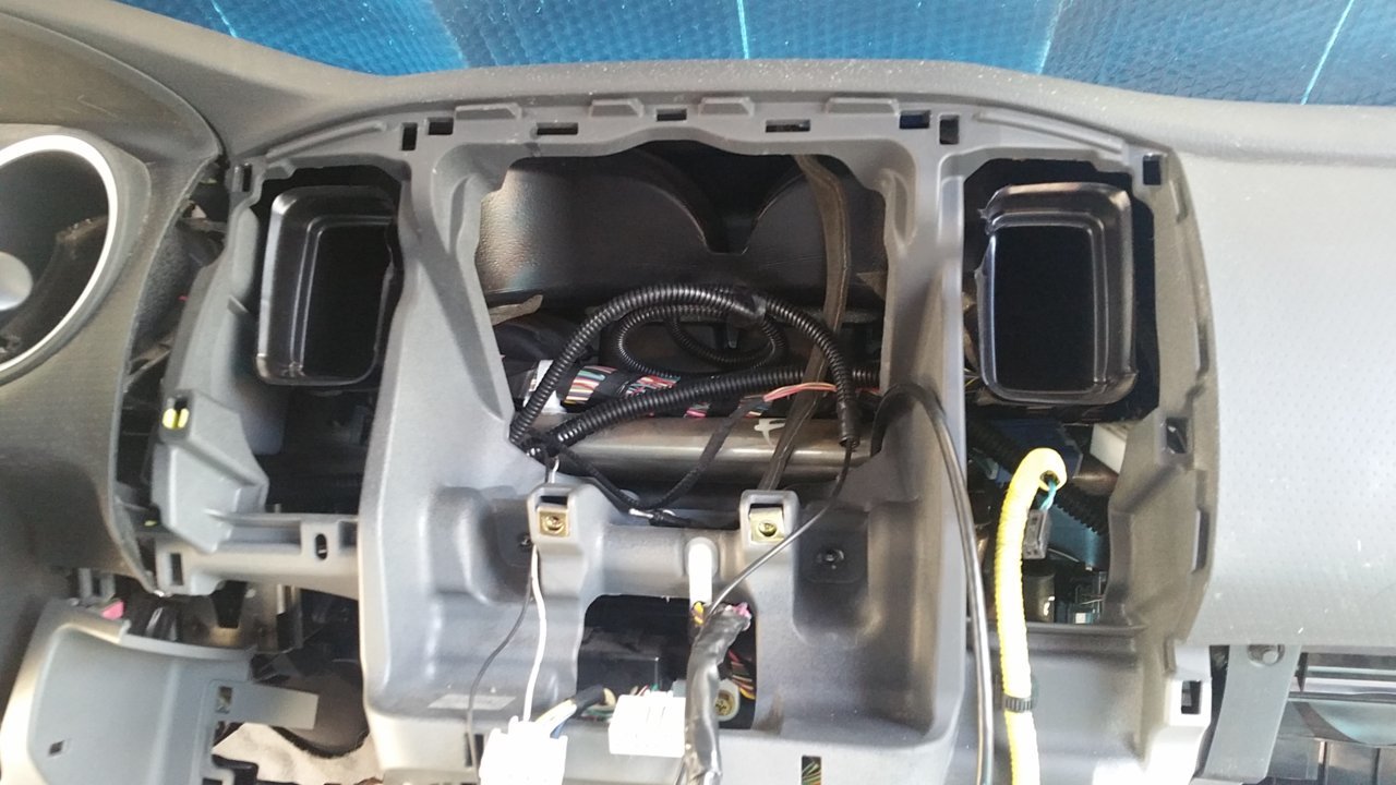

    I installed a Pioneer Nex Head unit, with a Pop-N-Lock camera on a 2006 PreRunner.
    Included iData Maestro to display ODB2 info, to include tire pressure data on the TouchScreen.
    Head unit has Apple Car play, and the camera gives it a full technology upgrade.
    "Got everything pre-wired from Crutchfield", so it was mostly plug and play.
    Ran the camera wire on the drivers side thru a rubber grommet on the floor board to the head unit.

    We went with a Pioneer Nex that did NOT have a CD/DVD player, considering the media would be driven via USB phone/tablet. I noticed the radio now weighs as much as a cell phone, with no moving parts.
    The rest of the family has Apple devices, so the unit was Apple Car Play ready, as opposed to Android Auto. NOT all units do both.
    I highly recommend getting the idatalink Maestro, and ordering from Crutchfield to include their Pre-Wiring service, that includes all the harnesses connected together for you. I enjoy wiring stuff, but not worth the headache. Their Tech support is responsive with any questions about the unit itself and the installation.
    I ordered the camera/latch/lock from another vendor.
