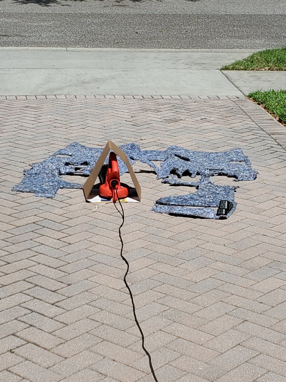

    I'm getting it done ASAP. Im not driving it until I get it done... My carpet padding was soaked so I've been working on gutting, cleaning, drying it all out... So far so good... Also cleaned a bunch of muck out from around the sensors in the back. WD-40 ing some parts and connections as well...
    Thanks again for everyone's input.
    Here's some pics of the progress...
