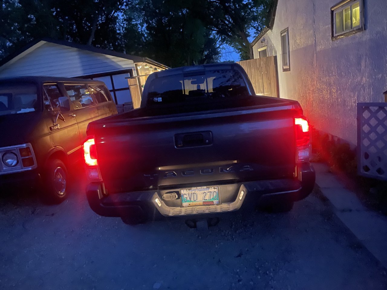

    8B105F5D-7701-41DA-A343-E7344CA00796.jpg My rear light on the passenger side only seems to light up fully half the time .. any ideas, would this be a warranty issue?

    Did you try changing the bulb?

    If its under warranty you can take it in. But its just a burnt out light bulb. Will cost you a few bucks at the local store for a new bulb you can put in your self, or 3 hours and gas money to have the dealership take care of it.

    Those bulbs have two filaments if i remember right - one lights up for running lights and both for signal. On rare occasion I have seen one filament burn out while the other remained functional for a short while.
    99.5%, its the bulb.

    I had a burned out tail light bulb in my 2021 TRD with 600 miles on it. Go to auto store and buy a $3.00 bulb and be done with it. Two bolts on each side and pull the light straight back and it will pop out. Quarter turn the bulb socket and pull it out. Mine wasn't LED.
