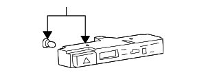

    Wow- that has to be almost microscopic! I'll search Google and get back to you...

    want to know bulb size as well. I replaced the HVAC bulbs a while ago with Led but I forgot the size. Might have been #74...

    Ha! I just went out and looked in my glovebox and found the package the correct bulb came in. Part # 90011-01058, Bulb, w/cap, quantity 2.

    Isn't there a bulb sticky post around here somewhere???? We should make sure this bulb is on there.

    I bought some neowedges off ebay about a year or so ago and they are still going. Trick is to find some with a low enough profile. I originally bought some off Superbrighleds and they were too long, which means you can't push the switch cause it makes contact.
    I'll post the eBay link in a sec.
    edit: they are T3s on my 2013. "Should" be the same for other 2nd gen years.
    link so if you want to buy elsewhere you know what you are looking for.
    http://www.ebay.com/itm/261450528282?_trksid=p2060353.m1438.l2649&ssPageName=STRK:MEBIDX:IT
