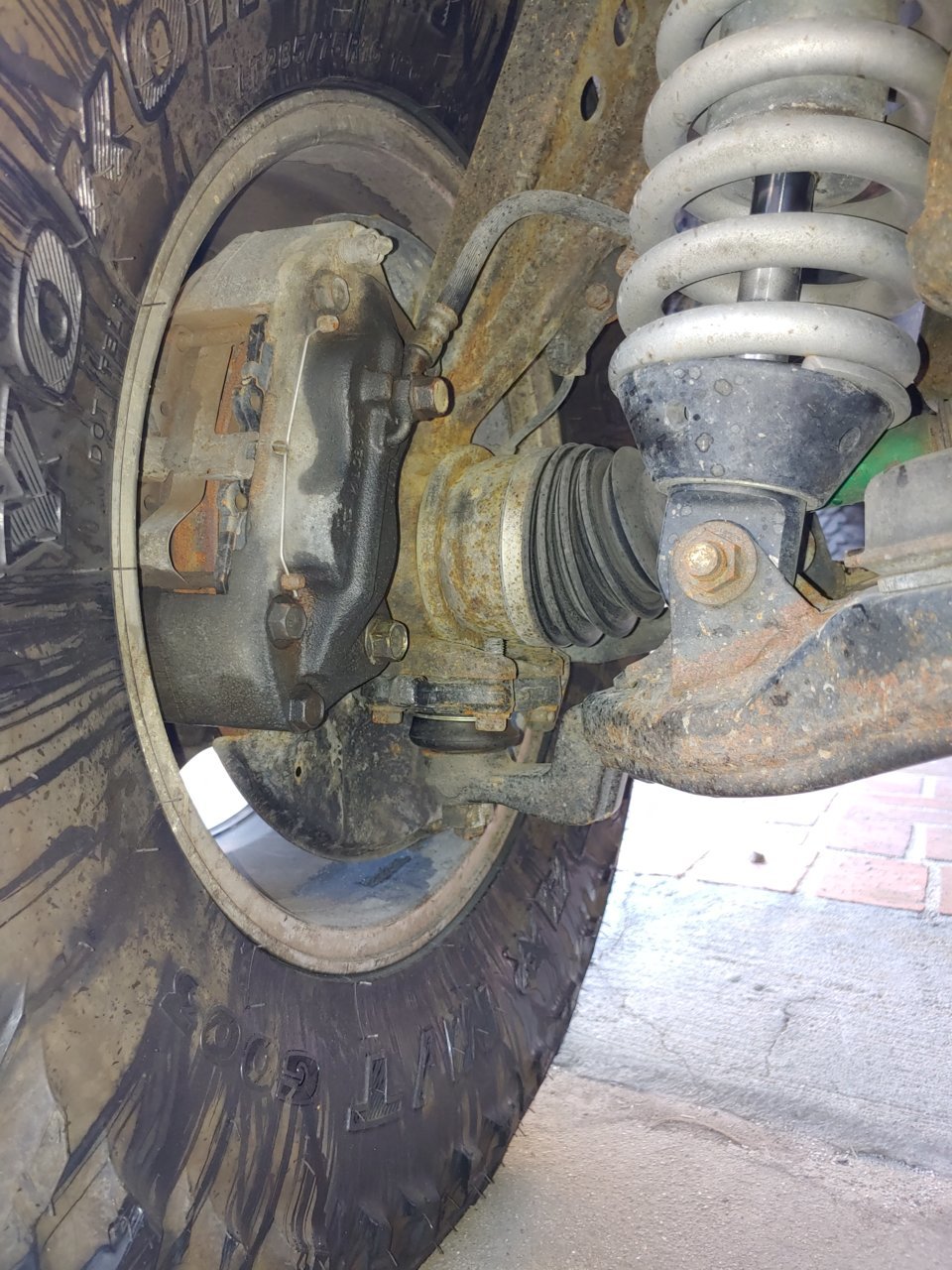

    CV axle had made contact with the bottom of my coilover immediately after someone hit my truck in a parking lot. Alignment was thrown off on the passenger side and so everything was moved just enough to skim the edge.
    I got an alignment within a few days and I was good again.

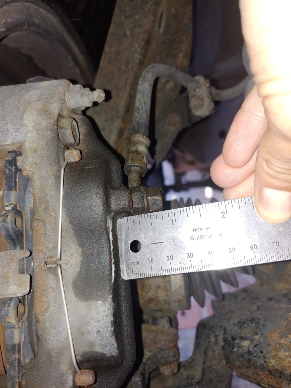

    Here's a couple pictures of my front pass setup. I was able to get a ruler in there as you can see and the stock line + banjo bolt sticks out about 0.75". Could you please measure your Wheelers setup and let me know the distance from the caliper to the end of the banjo bolt? Thanks in advance!

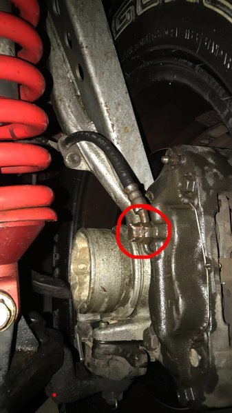

    Albert - the difference between your and Ben's setup is the position of the brake line on the caliper. On a Tundra setup (13WL calipers), the position of that input - be it for the banjo fitting or hard line fitting - is in a different physical location than the input is on the OEM Tacoma calipers. So, even though he's using a banjo bolt, his measurements are going to be irrelevant for you, since he'll be referencing off the Tundra calipers.
    Now, I wouldn't expect the OEM calipers/banjo to hit any coilovers, but I suppose there could be some coilovers that have a geometry that is slightly different than most, and so there could be interference.
    Another question would be whether there's something going on with your steering - as in, is your rack allowing you to turn more one direction (toward the driver side) than the other, and is it essentially over-extending in that direction, resulting in the banjo bolt hitting your coilover? Probably unlikely, but worth checking, I'd say.
    And, if you do end up wanting to go to Tundra brakes (and the associated lines), feel free to reach out. I'm happy to answer any questions you have after you read through the link Ben posted above.
