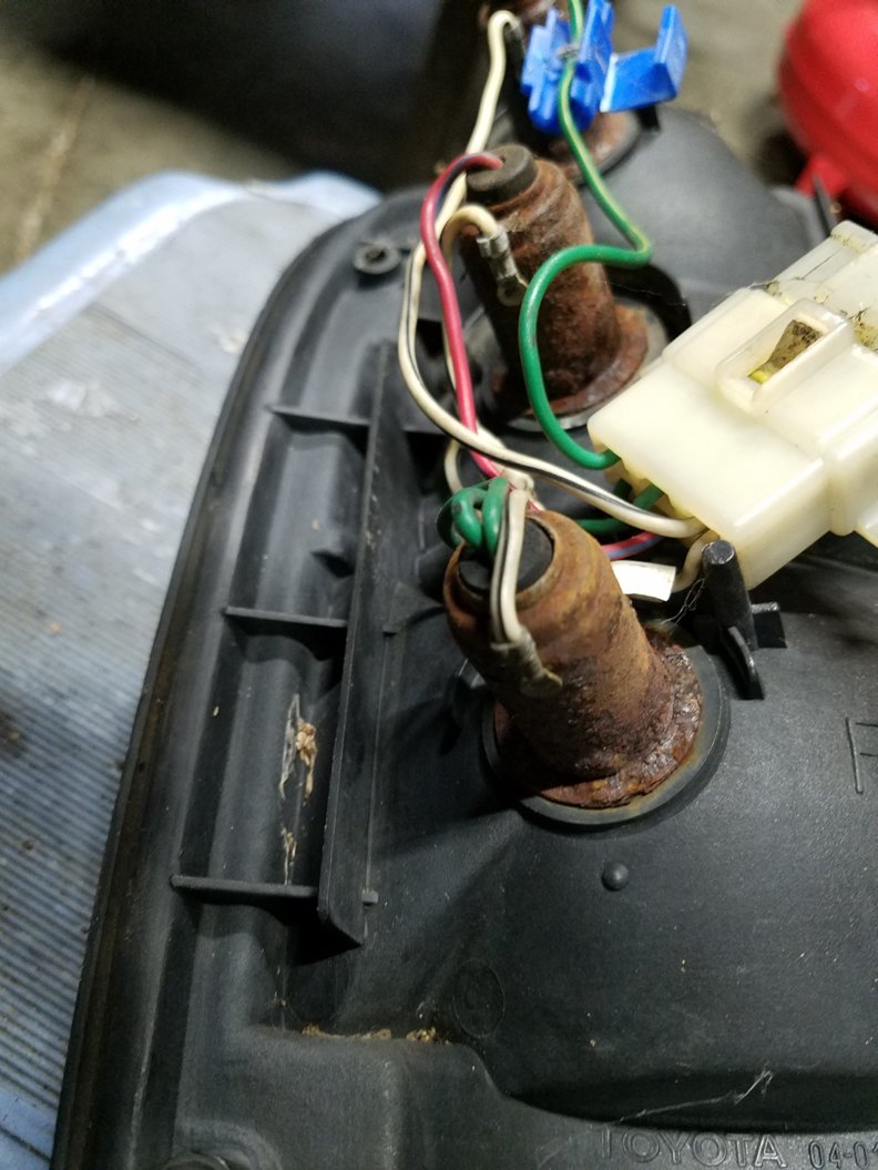

    Bad ground. Double check the connections at the ground on the housing and double check all the connections and connectors

    The ground system on our rear lights is prone to rusting and causing strange things back there. As you can see, they are tied together, so the rust can cause various symptoms. Worth looking at on your truck.
    Pull the lamp out and use a piece of scrap wire to run a temp grnd and see if it fixes your problem. Clean a small area of the socket with a file or metal sanding paper to use the temp grnd wire.

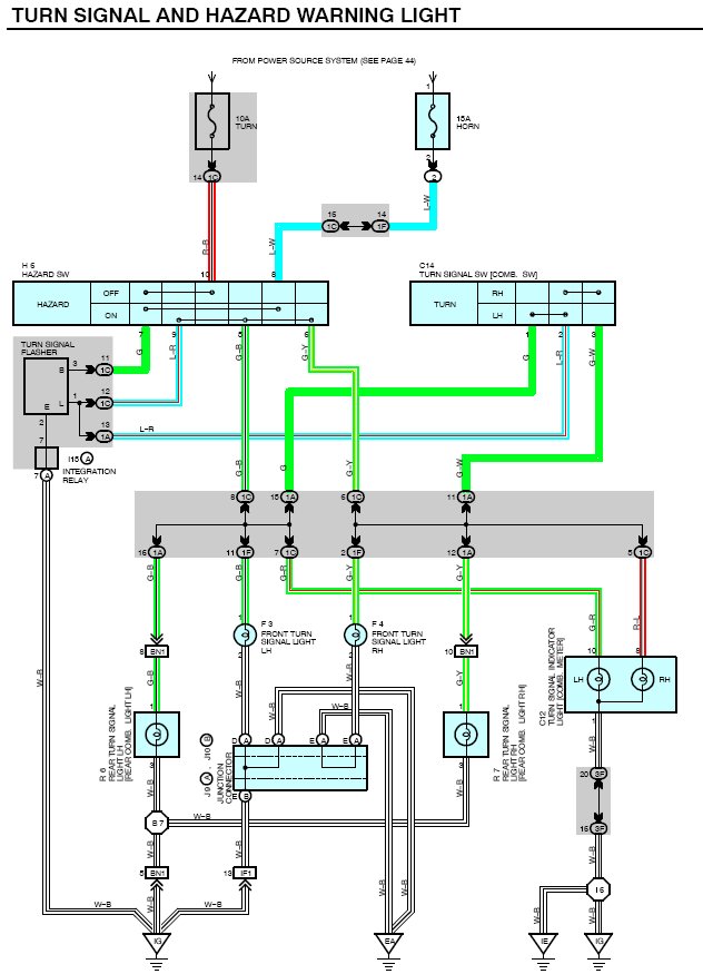

    There is no such thing as "hazard relay". Both: turn signal and hazard lights use the same "turn signal flasher" (10-15 dollars for aftermarket LED compatible flasher). Hazard light switch is just a simple switch, same as turn signal switch, both connected to the same flasher.

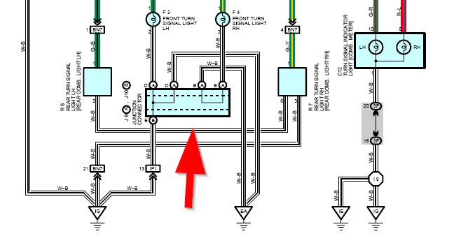

    NO. You can completely disconnect the turn signal switch and hazard lights will still run. However you can't do otherwise: turn signal runs through hazard light switch. If you disconnect hazard light switch, nothing will work: hazard nor turn lights.
    If hazard light switch is in "Off" position it powers a flasher from 10A Turn fuse power. Then flasher powers turn signal switch which will activate left or right signal lamp.
    If hazard light switch is in "On" position it powers a flasher from 15A Horn fuse power. At the same time it activates the flasher powering both left and right signal lamps.
    From 99 EWD which is the same for all years except grounding of tail lights in later models.
    Later model tail light grounding is different - left light is not grounded directly like on previous models, but through right lamp. I have no clue why Toyota changed that. Seams to be stupid "improvement".
