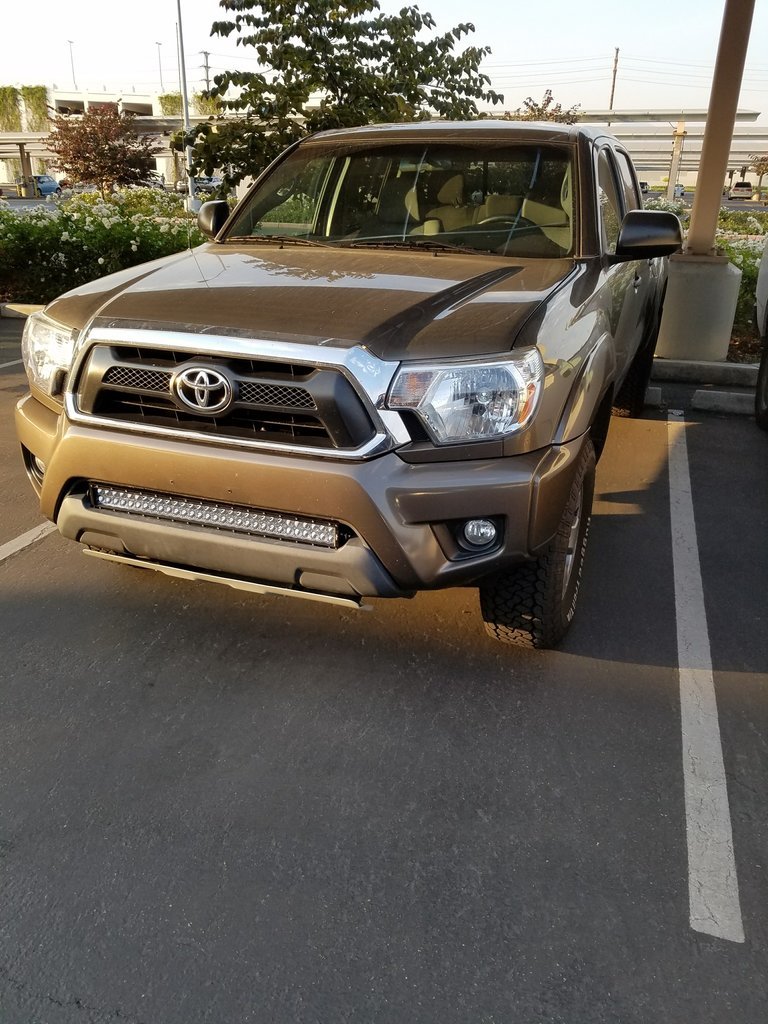

    Sold off the side steps, rear bumper grandpa step deal and bed extender, bought a super cheap Amazon 30" lightbar, and started planning out upgrades. Got the lightbar installed with a less clean plastic cutting job than I would have hoped, but...oh well. Looks good from 5' away...

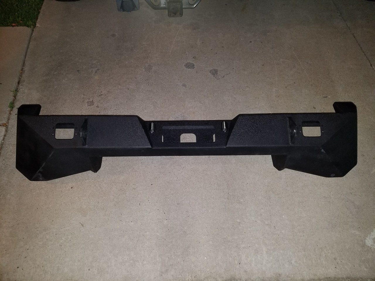

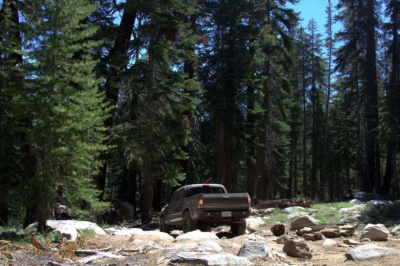

    Been scouring the net for a camper shell and other parts, researching skids, sliders, armor, etc and stumbled on a nice little Craigslist find... DV8 rear bumper, returned for a few scuffs. Thing is BEEF. I have some lights coming for it as well.

    That's some epic boulder crawling in that photo! Respect!

    Nice score on the rear bumper.

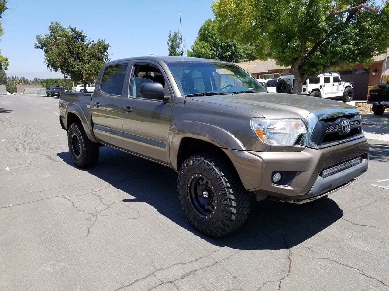

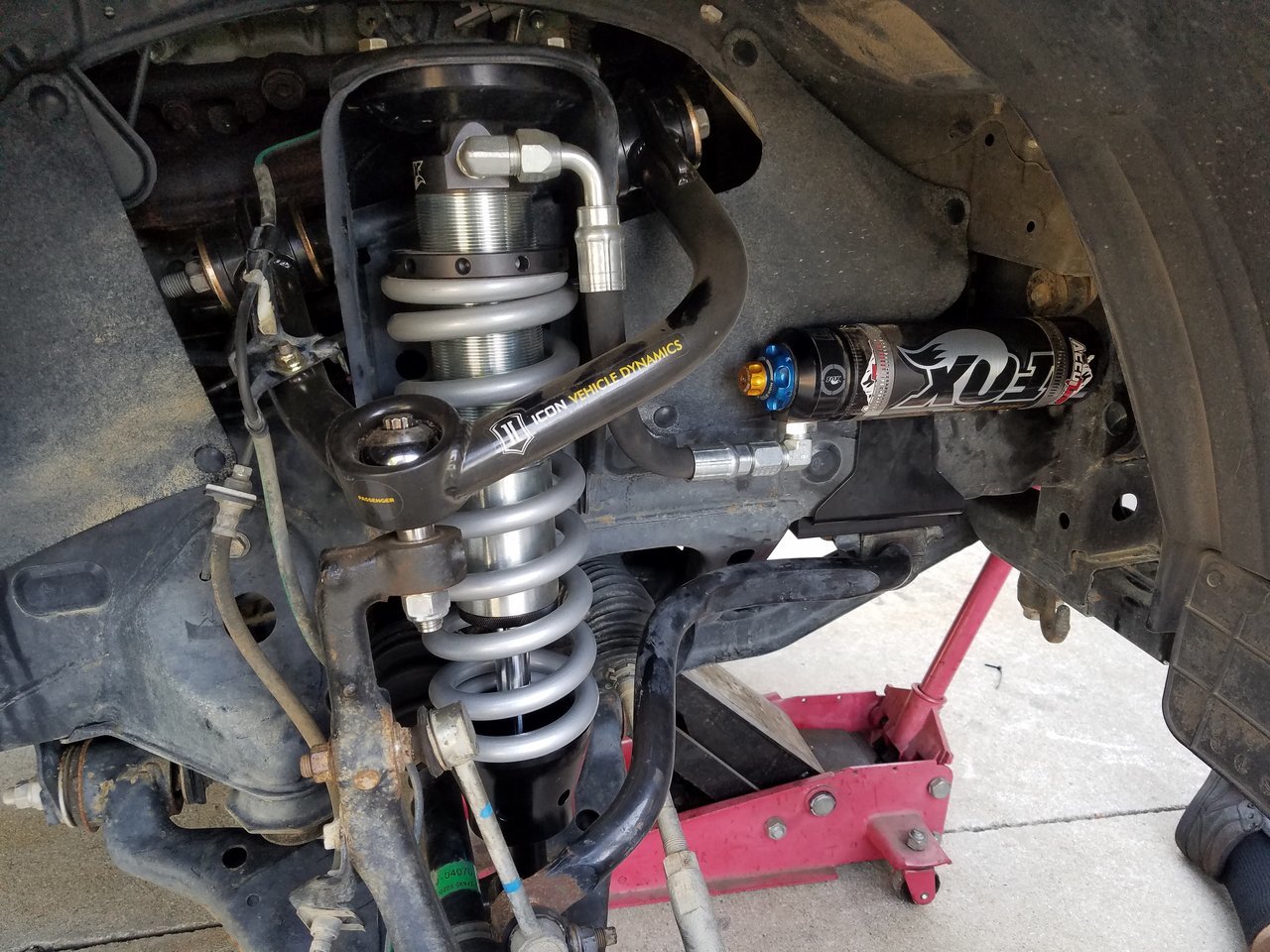

    Got some new bling installed yesterday

    nice rides way better doesn't it? and keepin the sway bar, eh ?

    Ride is night and day. The DSC adjusters are nice, but I need to run them near all the way closed for a decent ride without blowing through the travel. Good thing my buddies at Accutune are going to get them re-valved. Fox is out of stock on my rears, so it's an odd ride right now, you can tell how bad the rear is over just about anything, compared to the front. I'll play with the swaybar once I get the shocks dialed in, but right now it doesn't seem like it's getting in my way for anything yet. Going to get an alignment today hopefully, then get my tires on and see if I feel like getting new Falkens this week before heading up north to go camping/wheeling.

    Right on man. wheels and tires are going to be a game changer for sure. I just pulled the sway bar off when we installed the shocks. I don't miss it.
    We are in the same boat now. I've got the 2 inch lift block the truck came with and the stock bilsteins and it rides like complete garbage compared to front.. lol I was looking at some 2.0s for the rear to hold me over but I'm just going to wait until do a spring under set up and get some real shocks. I had 2.0 fox on my rover years ago those things heat up in 2 seconds in any high speed sections.
    Get those wheels and tires on and post some pics!
    MarX and christyle [OP] like this.

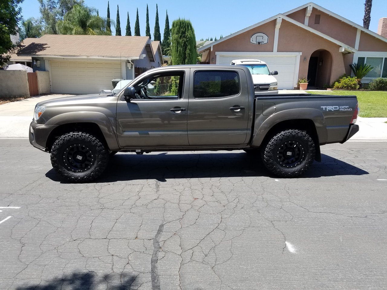

    Well, got the alignment and the rims and tires on...and it rubs everywhere haha. I did some initial trimming of the fender and liner but looks like I need a but more, and these aren't even the 285/75s... Probably need to crank these up a little bit more than "leveled" too 20170808_124128.jpg 20170808_124142.jpg

    Well that didn't take long...
    I ain't about that mud tire life. I am, apparently, really into that rubbing all the hell over life tho. DGAF and wheel it this weekend

    lol looks better. New tires 285?

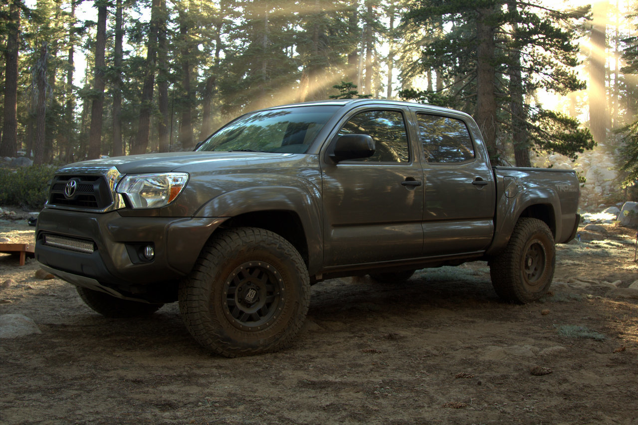

    Went from 285-70 Nitto Mud tires i got off craigslist to 285-75 Falken wildpeak AT3Ws from Americas' Tire.
    Now I DEFINITELY hit the body mount and a pinch weld or two, maybe some more fender liner/flare. I'll hammer it back/trim it/burn it with fire until they sort of kind of fit tonight. I'll box it in when I get back from this trip. At least it doesn't seem like a sharp edge to really do damage? I'm getting some rub on straight compression tho, gonna have to see where, or leave it and find out when it rips something off. I'll be adding probably an inch more preload when we pull them to put the Accutune valving in and get my rear shocks on. Going to dick with the DSC too, back off a little on the low speed.

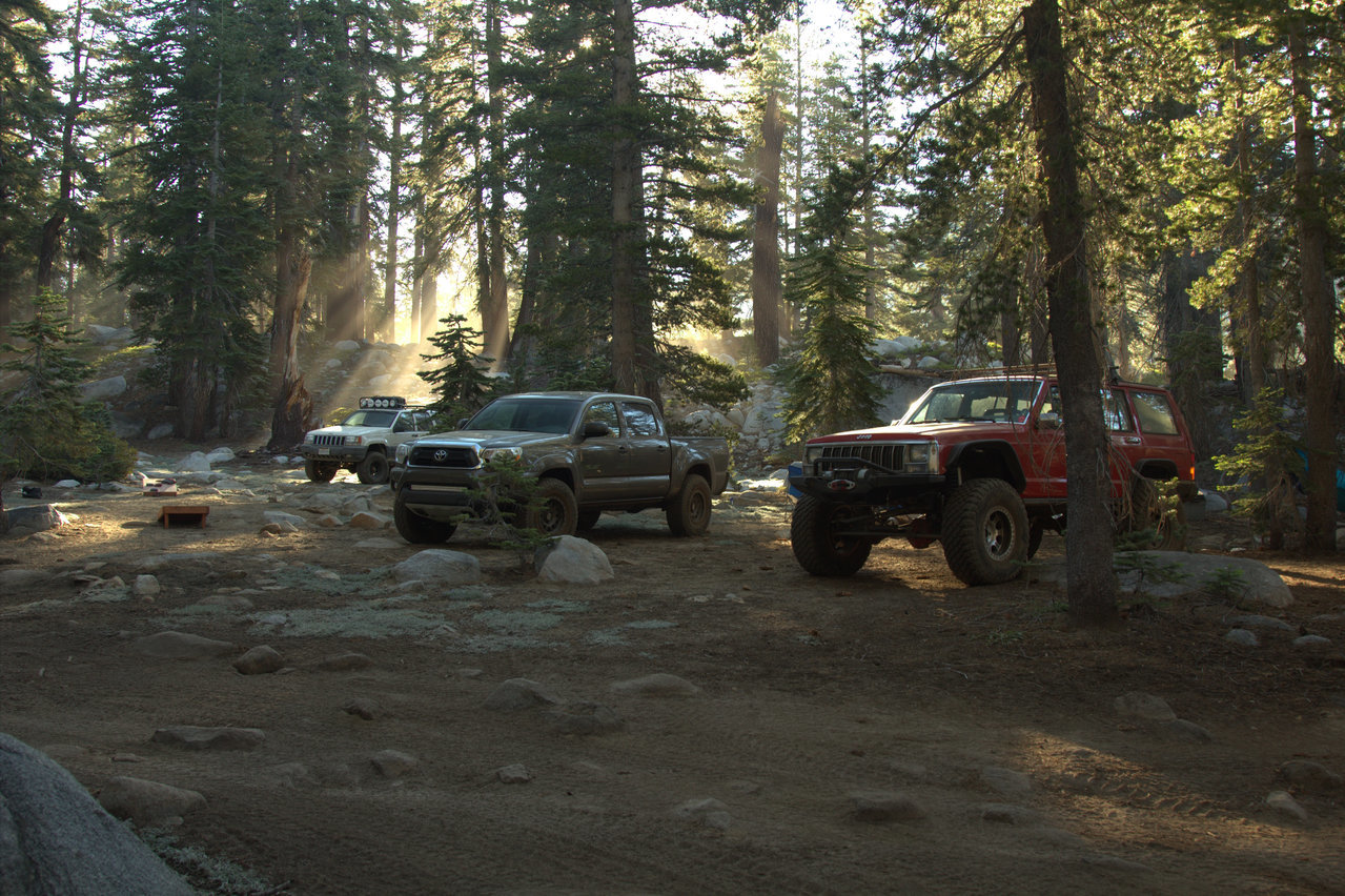

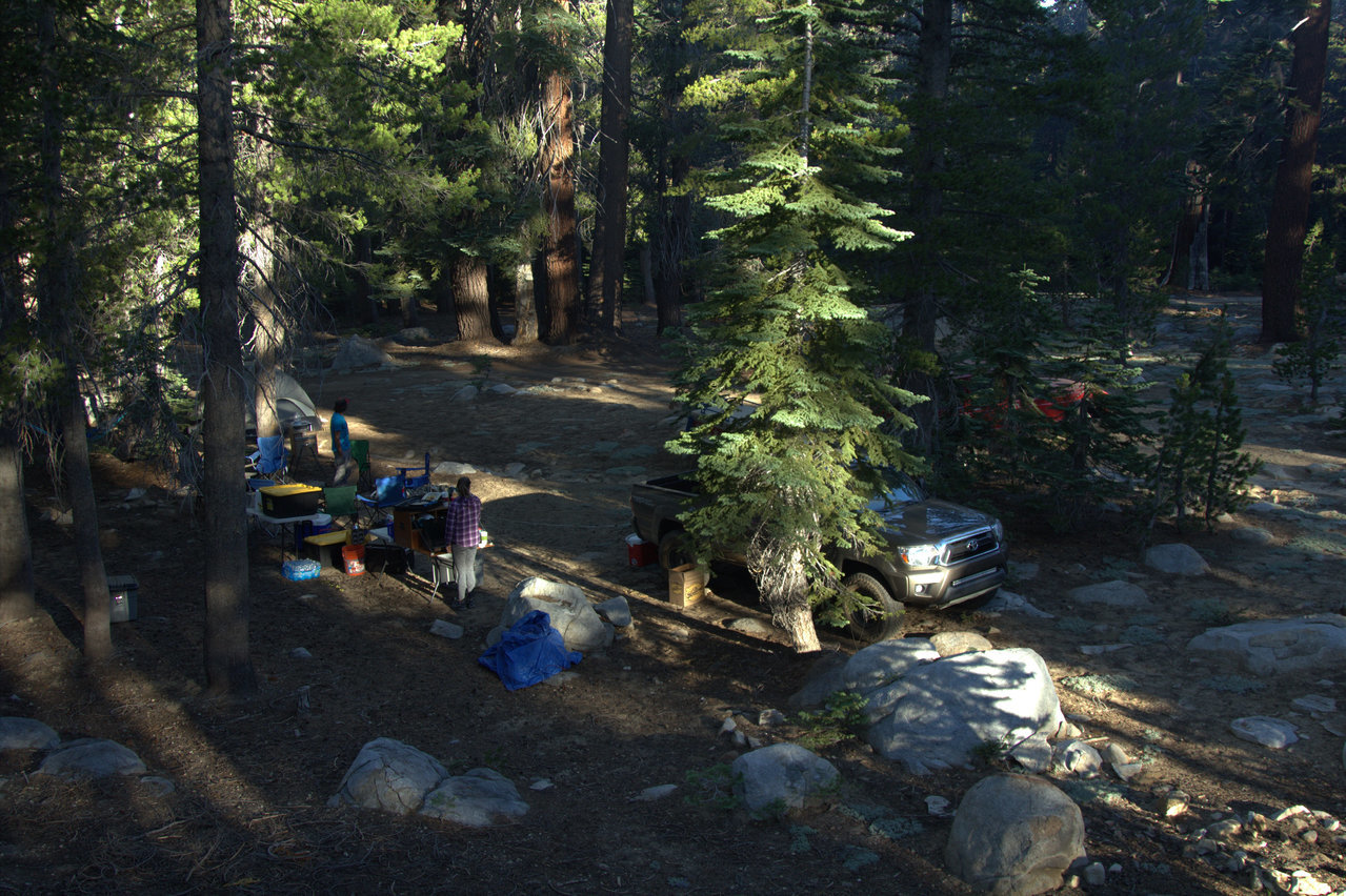

    Took the Tacoma on it's maiden voyage up to West lake near Fresno and then a day trip over to Strawberry Lake to push the limits of my tire clearance. Tires rubbed everything, all the time, even after body mount trimming, inner fender trimming and fender flare trimming. Seemed ok at home, but on the trail it hit pretty often. Definitely need to do more clearancing and plating the body mount, possibly some more flare trimming, definitely trimming of the rear flare, as it was really rubbing and eventually popped my flare partway off on the passenger side. I'm thinking of just trimming the whole inner attachment flange off and taking some of the fender itself with it.
    Rear was on bumpstops whenever it had a load in it, so definitely need to get my buddy's AAL installed as well as crank the front up another inch once Accutune tunes the fronts.
    In true overlander fashion, I took way too much crap with me on this trip and will be downsizing a bit for next time, as well as adding some bed lights, bed braces, floormats, some better gear organization/retention, and eventually some sliders. Enough yapping, on to the pics
    Traegermaster, MarX, josem3 and 3 others like this.

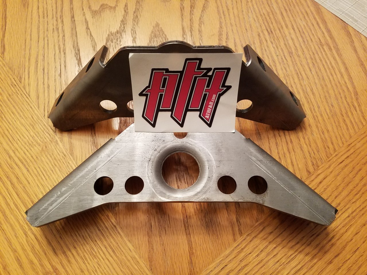

    So I guess camping spurred some spending sprees this week. And opportunity knocked.
    Picked up a set of bed corner braces from @At The Helm and have the bed braces on their way as well, since I'm sure the amount of off-roading I plan to do will eventually cause some damage. I plan to use the brace to mount a bed light/eventual dust light using one of the crap Amazon flush mount LEDs I impulse bought for my bumper and promptly got replaced with some GG Lighting lights by a buddy of mine. Then ended up stumbling across some sliders for sale here and cruised out to pick them up, as well as some Icon 2.0s to tide me over until my foxs finally come in.

    Well done sir. I hate it when those impulse buys happen. You have too many of those and you are going end up with another built truck if you're not careful.
    Now you just need skids, front bumper, winch, front Long travel, rear long travel, bed rack, RTT........................
    I was actually scoping those Icon rears. haha Curious how much different the ride will be.
