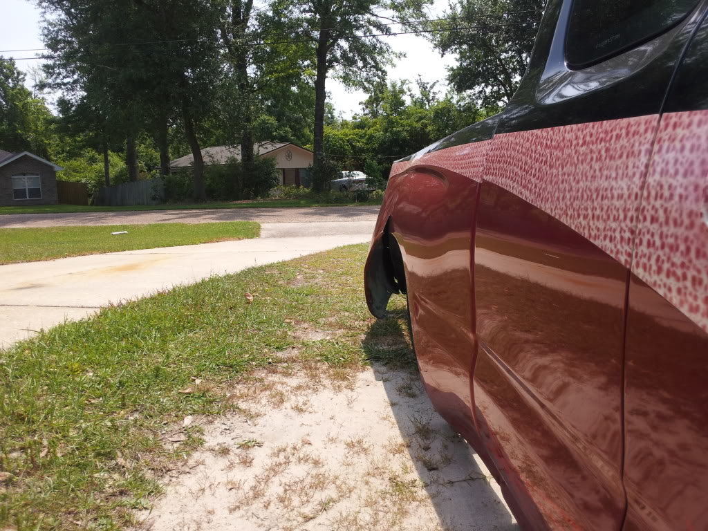

  3. Apr 11, 2012 at 10:59 AM
    #83
    dooredtaco
    dooredtaco [OP] Well-Known Member
    Feb 1, 2012
    #71922
    117
    97 doored xtracab, 02 double cab
    lol it gets just enough lift to clear the tires

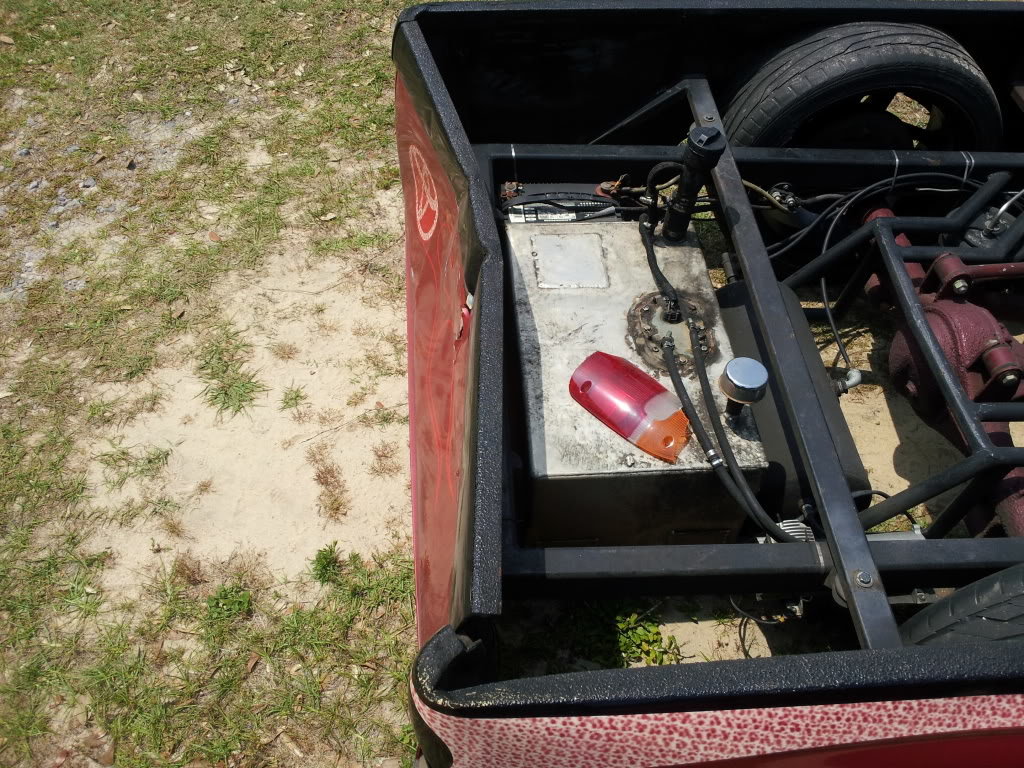

  4. Apr 11, 2012 at 11:34 AM
    #84
    dooredtaco
    Feb 1, 2012
    #71922
    117

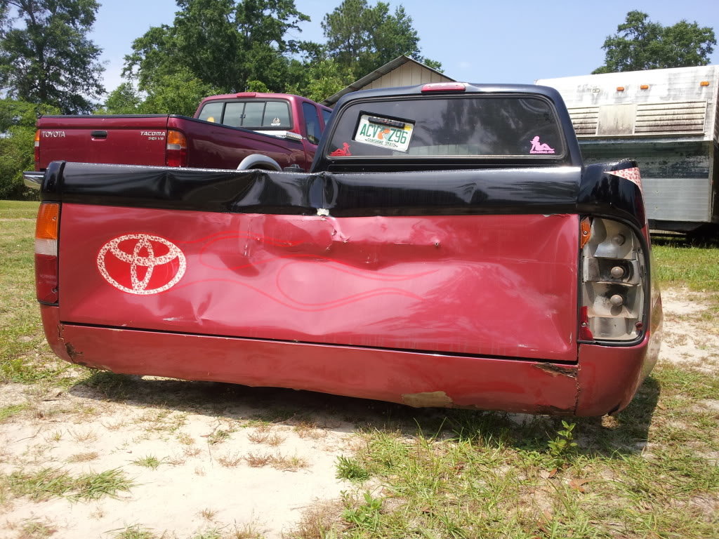

    took a few daylight pics today of the carnage. i was about to redo the floor and walls to this bed soon so its a good thing i hadnt started on it yet lol.

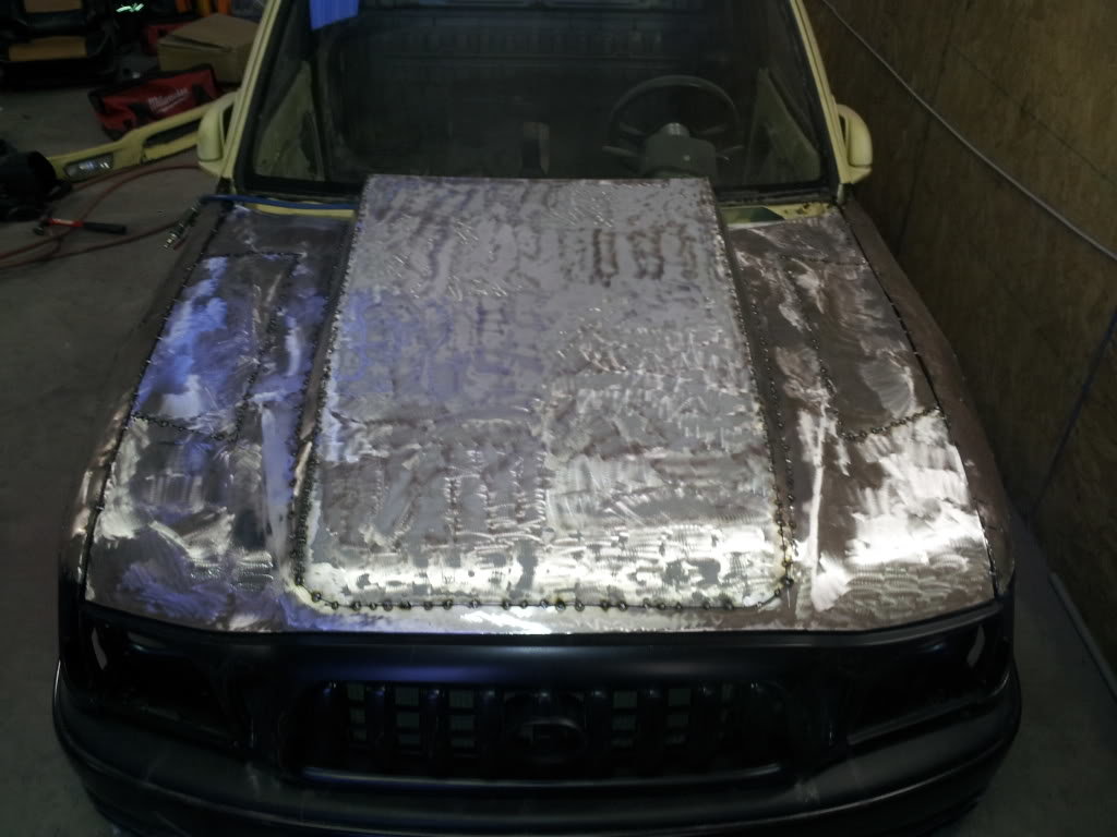

  5. Apr 12, 2012 at 6:49 PM
    #85
    dooredtaco
    Feb 1, 2012
    #71922
    117

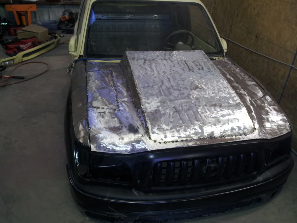

    hood starting to come together

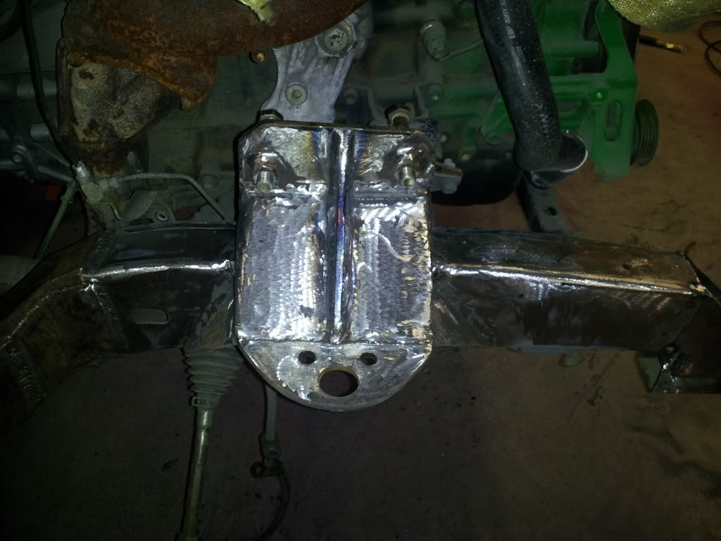

    beefed up my bag brackets and where i raised my upper control arms

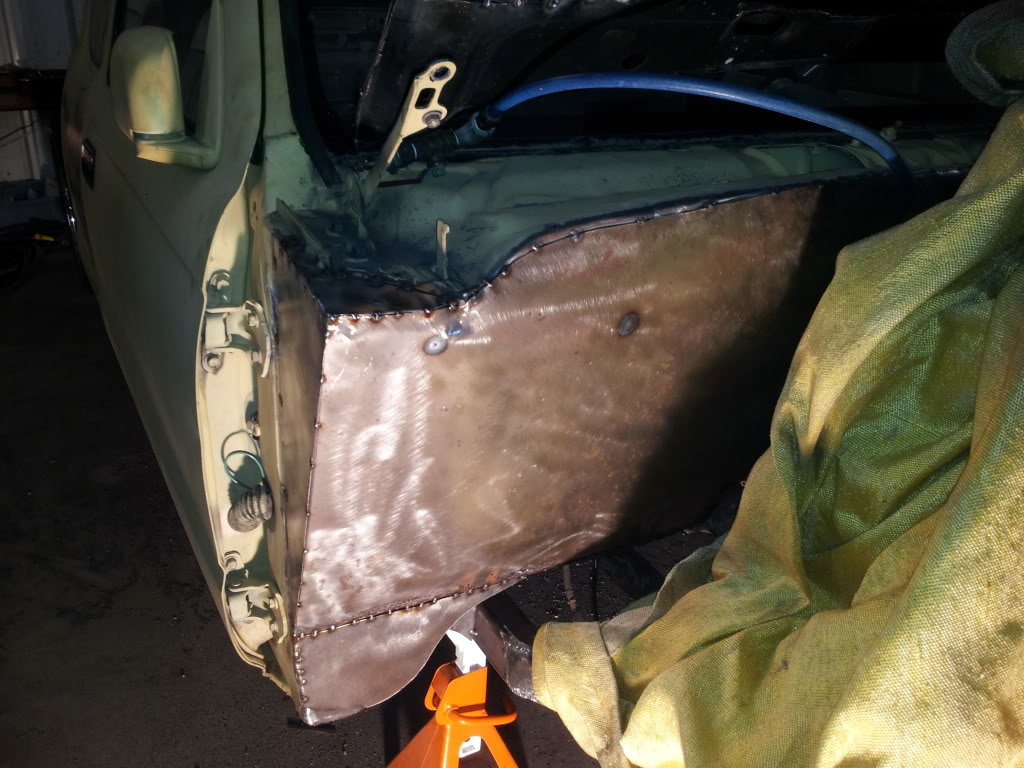

    was up pretty late last night on the truck
    a lil bit of 3:30 a.m. firewall action

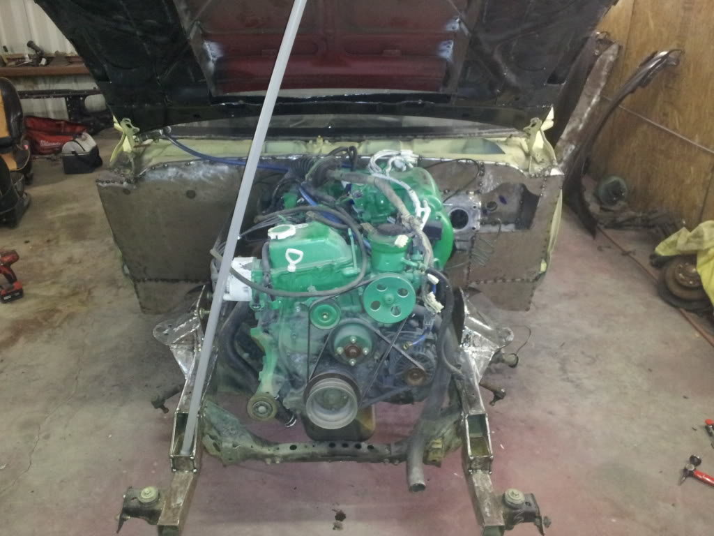

  15. Apr 22, 2012 at 9:01 AM
    #95
    dooredtaco
    Feb 1, 2012
    #71922
    117
    thanks everybody for following the build and the support, it for sure helps keep motivated to do this stuff and to put all of our time and money into these money pits i mean trucks.
  16. Apr 22, 2012 at 10:44 AM
    #96
    HomerTaco
    Mar 28, 2010
    #34129
    45,874
    HomerTaco
    HomerTaco
    HomerTaco
    :woot: thx for the update.

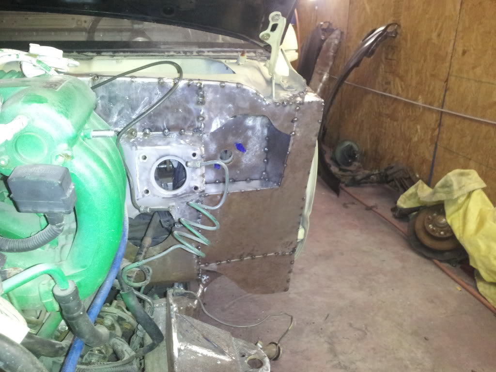

    I'm curious... Why did you have to fab up a whole new firewall?
    Does the lowering process require more room in the engine compartment?
    I understand the hood mod - you lower the body but not the engine... :cool:
  17. Apr 22, 2012 at 11:06 AM
    #97
    xJuice
    xJuice My spoon is too Big!
    Oct 24, 2007
    #3208
    9,909
    Josh
    N. Texas
    19 Tundra MGM
    TRD Front & Rear Sway Bar, TRD Pro LED Headlights, Undercover SE, Rear diff. Relocate, console organizer, debadged, color matched handles, mirror caps, and grill
    A lot of times firewall mods are required to lay out with larger wheel/tire combos. Similar to the cab mount chops on our trucks but these wheels have to go much farther up.

  19. Apr 22, 2012 at 1:05 PM
    #99
    dooredtaco
    Feb 1, 2012
    #71922
    117
    Yeah i lowered my motor as low as i could put it to get as much clearance as i could for the hood most tacomas you wouldn't have to do all this with but this one is so low with the rocker panels cut off so had to get crazy with the cheese wiz on the hood and fenders lol. You would usually only have to tub the firewall for the wheels but i wanted a smooth firewall cause my paint and graffics are gonna flow onto the firewall also and the back wall that will never be scene behind the bed lol
  20. Apr 22, 2012 at 8:47 PM
    #100
    dooredtaco
    Feb 1, 2012
    #71922
    117
    done building the firewall just gotta weld it all up now and made a lil cubby hole for the clutch master cylinder
