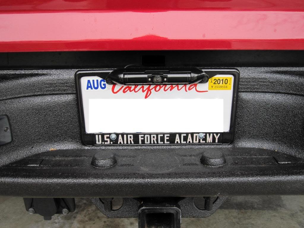

    Another option are the license plate cameras by Boyo. I am very pleased with mine. Here's a shot of the camera:

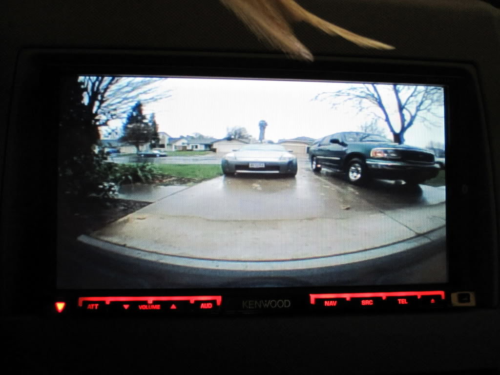

    And a shot of the view through the headunit -- I can easily make out the edge of my bumper and get VERY close without hitting anything behind me:

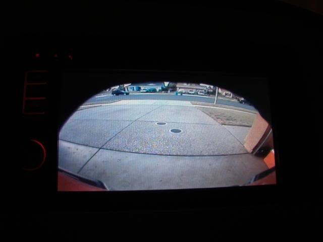

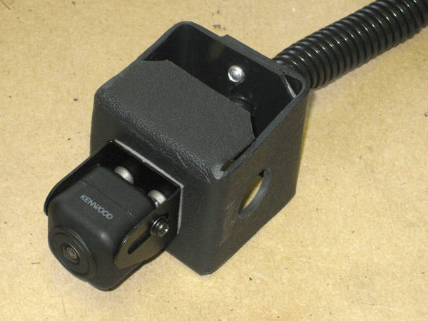

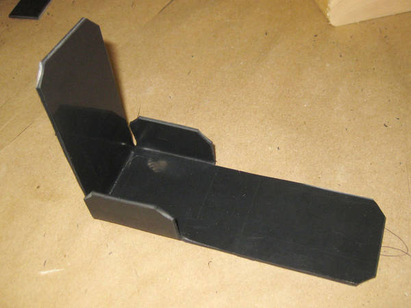

    I had a tow hitch receiver on my last truck for 7 years and used it zero times. I figured I'd put the one on my taco to use, so I bent up a little leftover kydex I had lying aroound. Yes, the viewing angle is a bit low but it's well protected, looks clean, and if I do need to tow something I can easily push it deeper in the the receiver & add the hitch with no problems.

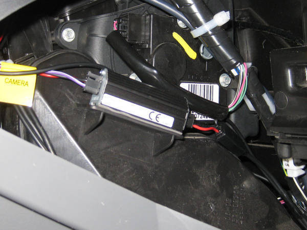

    And anyone with a kenwood camera, take your glovebox out and you'll find a perfect little shelf to mount the in-line component on. Looks like it was custom designed for this purpose.

    Nice . . . you found the Toyota pre-installed camera component shelf. I like the idea of hiding the camera in your hitch reciever. Thieves not likely to look there.
