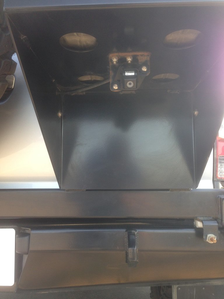

    The brackets gor the cameta are not flush with eachother its pritty stupid set up. I relocated mine with my swing out.
    18548F80-F139-47D5-8301-86F47122A823_zps_1c2c864b4fddca1bf15d17a17604e82601e5d381.jpg
    Where the bolts are, are offset by an inch
