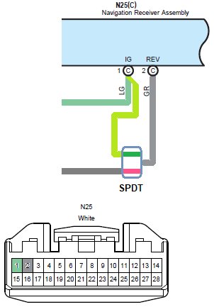

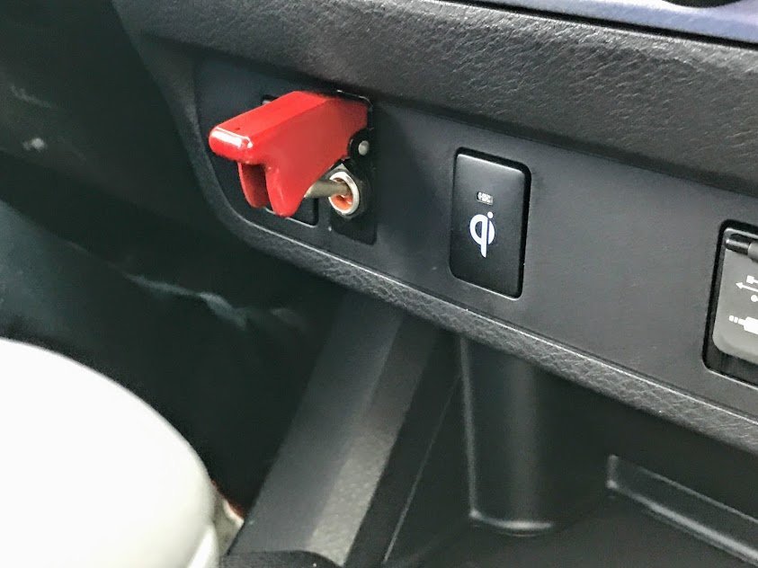

    I saw a post from 2017 about how to switch the back up camera on without being in reverse.
    I understand how to do the mod, but when I followed the link to the actual switch, there were many thousand to choose from. I know it is a SPDT aircraft switch, but there are 1034 pages of SPDT switches on the linked site. (maybe I did something wrong). The poster was Fresh Mexican Taco. I would appreciate anyone who could provide a direct link to the switch and also I couldn't tell whether or not the blank switch hole needed to be modified to accommodate the switch.

    Thank you for your quick response! I saw that switch in my search, but the tread I referred to said you need a SPDT and this one is SPST. The back up cam needs to be isolated when the switch is used to view the camera. Position A normal, position B bypasses reverse back up turns camera on. I think (and I am definitely not an expert), that SPST would only turn the normal operation of the the back up camera on and off.

    Thank you! I saved your wiring diagram file for reference. Do you have a link to a switch?

    I saw one a couple of years ago that just said "rear camera or just camera" with a camera icon and I bookmarked it but I can't find it and can't
    remember if was SPDT either. That's really what I want, but the one in the 2017 post was pretty cool too! Might be too cool for me but I would use it
    with the hope of one day finding the custom camera switch.
