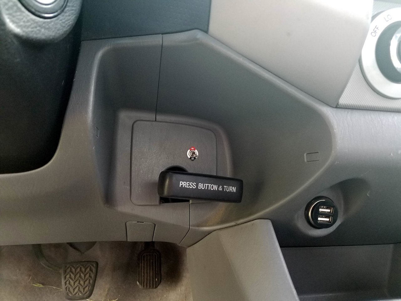

    Thanks, OP! That's a great idea to wire it to a switch. I'd like to do that.
    If you don't mind me asking...where did you mount the switch and what kind did you use? Any pics you could share? I've never wired a switch before...so that's going to be a new one for me...electrical is not my forte':anonymous:...I did manage the black box removal...so I can follow directions!!! :pccoffee:
  8. Jun 8, 2018 at 8:10 AM
    #28
    bluezzy
    bluezzy [OP] Love My SuperCharged 07 Sport!
    Feb 3, 2016
    #177007
    2,258
    Monty
    Eugene, Oregon
    Here is a pretty good vid on how to do all the wiring and then instead of having to find the reverse wire I just found a hot wire and went straight to the switch instead.
    Oh yah, the vid:
    https://www.youtube.com/watch?v=W4aAD5oCutw
    Manfred and Geronimo1111[QUOTED] like this.
