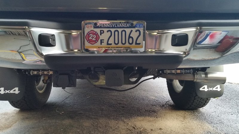

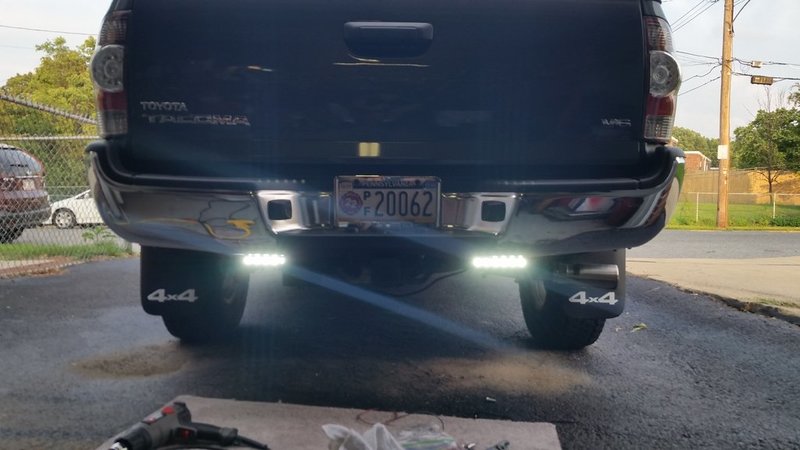

    I used a relay and a switch. The wires are all tuck up and secured.

    I used a relay and pulled power from the battery with an air on board switch to turn them on. I didn't want them to come on every time I used reverse only when I needed them.

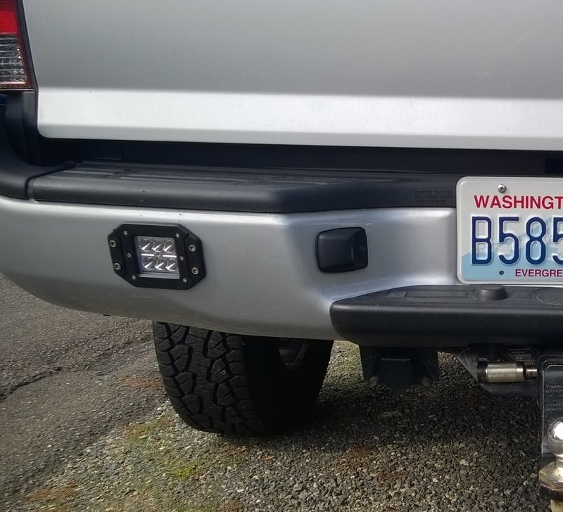

    Those flush mounts look awesome! Dont really want to cut into my bumper tho.. Hmmm

    Not a fan of reverse lights mounted below or in the bumper. You run the risk of them being damaged when off-roading or getting rear-ended.

    Measure once, twice, outline the opening with painter's tape. Back off and look at it, measure 2-3 more times. Then get up the nerve to breakout the cut-off wheel. Once you make the first nick in the bumper with the tool, all the nerves go away and you just finish the job properly.
    Then you find out you are about 1/4" too close to one of the bumper braces to get any normal wrench on the back of 2 of the mounting bolts. Have a "d'oh" moment, think about it for a few minutes, cut a sacrificial box wrench in half, thank the maker that you were blessed with smaller hands and get the job completed. Stand back, and admire your work.
