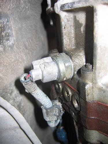

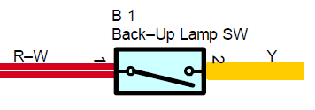

    Fuses?
    And the reverse switch would be a prime suspect

    Probably the reverse switch on the side of the transmission, easy enough to check. Unplug it, jump the terminals of the connector with a wire or paperclip no bigger than the male pins on the switch, and see if your reverse lights and camera come on. If they do it needs a switch, if they don't then we'll have to look further.

    Reverse switch is on the passenger side of the manual transmission.
