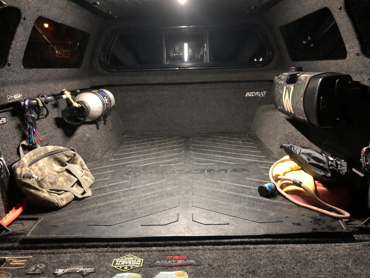

    I have mine mounted to the front wall of the bed with a powertank bracket. It's secured using stainless steel rivnuts. You can kinda see it here. This placement allows me to leave the tank in place and reach all 4 tires with the hose.

    That's a nice mount. Which bracket is that? Roll bar, BTS, or JLU?
    What size bottle? I have a tonneau so don't think that would work unless you are using a 20 lb. I have two five pounds that fit upright under the cover.

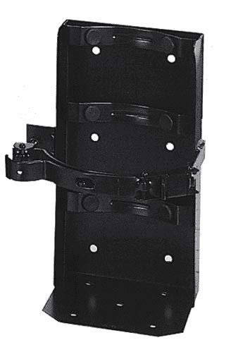

    You can use an Amerex fire extinguisher bracket suitable to fit your cylinder diameter. They're about $40-$50...

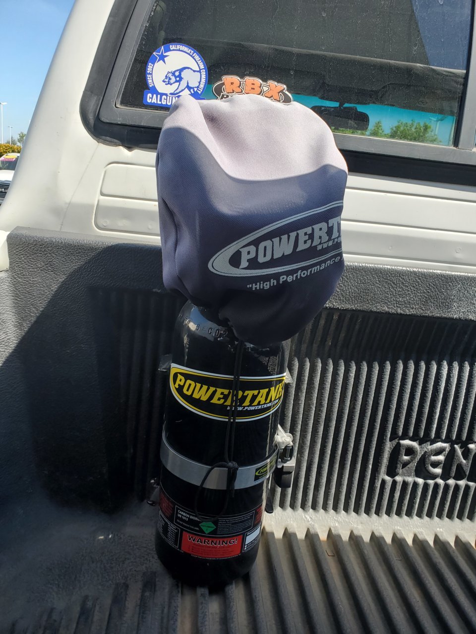

    Bracket is pretty cheap considering the cost of the whole system; I use one for my own Powertank.
    Will post pic in a bit
