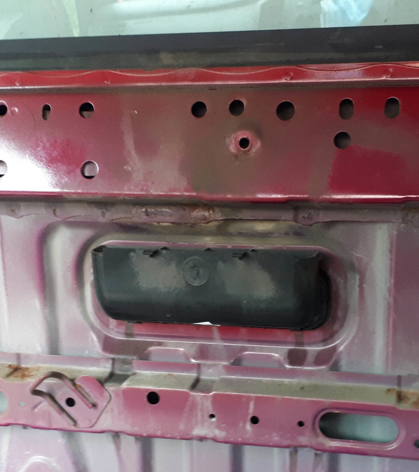

    Procedure for removing this vent?
    It is leaking into the cab and I can not tell if it is screw in, snap in, glue in, or a combination.
    It looks to me like I have to take the truck bed off to fix this thing and I am hoping that is not the case.
    can I just push it through without breaking anything?

    it was coming from the break light as well... and from the front glass.. but I will get to those after this.
    the seal on the vent is rotted through and I think a rat pulled out the foam as I can see it hanging off the vent between the cab and the bed.
    I have removed every interior panel as well as the ceiling
    several years of mushroom foraging takes you to some wild places... the vehicles do not always like it.
    You can see the streaks where the water is coming in right under the vent if you look close

    The pressure vent comes loose easily, if the seal is as compromised as mine was, by depressing the bottom two clips and pushing.
    Because there is not enough space between the cab and the bed of the truck to actually remove the vent you will have to remove the bed of the truck to replace it.
    I elected to fix it using Lexel Multi Purpose Sealant. If done properly this will likely last longer than the truck. This stuff sticks to EVERYTHING, is super elastic, and crystal clear.
    IF you have super skinny arms or access to someone with super skinny arms you could possibly clean and re-seal this vent by sitting in the bed of the truck and reaching down between the bed and the cab... possibly.
    I have neither skinny arms nor access to them... and I have a contractors cap in the way so this is how I did it:
    - pop vent through as far as it will go.
    - find flexible small bottle brush and bend brush so it can be used to clean the space between the outside wall of the truck and the seal on the external flange of the vent... this is annoyingly time consuming.
    - clean off as much dust and debris as possible before getting some gentle degreaser on the brush and doing it all over again.
    - rinse thoroughly and allow to dry
    - get you favourite sealer and lay a very thick bead as close as you can get to the opening on the top side of the vent and work it through with your finger as best you can. The idea is to get a bunch of the sealant through the gap and in a position such that when you put the vent back it creates a nice water tight seal between the compromised foam seal on the external flange of the vent and the back wall of the truck. Do this for the sides and bottom as well. You will need to work the vent side to side and up and down in the hole a bit to ensure you get enough sealant through so that a nice seal is produced when you finally re-seat the vent and fully engage the clips.
    - once the vent is properly in place lay another bead around the edges of the vent and run your finger around it to ensure there is a nice seal and preferably no air gaps.. like caulking a tub or a sink.​

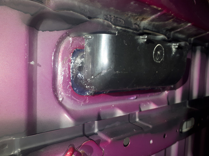

    Here is what it looks like once the sealant cured. Not my prettiest work but it is solid... except I see a rust spot I appear to have missed spraying with the rust treatment.
    inwood customs and koditten like this.
