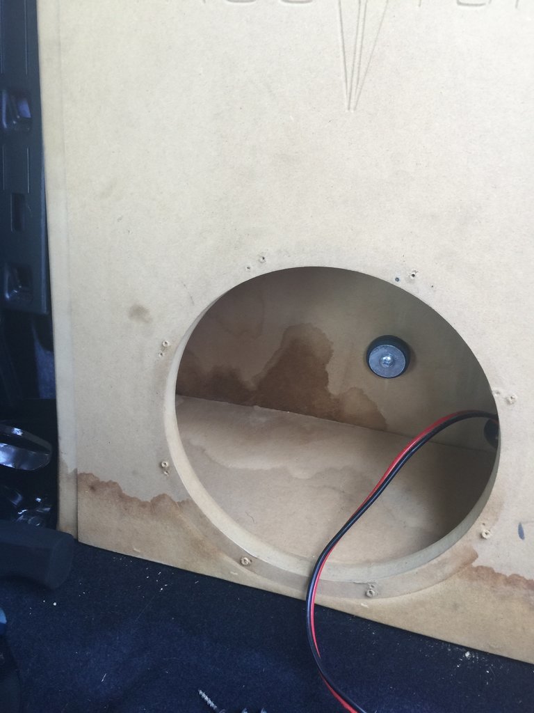

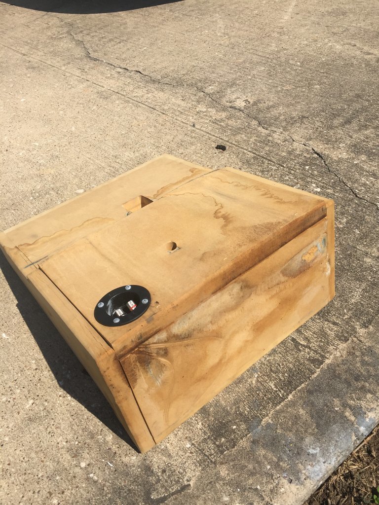

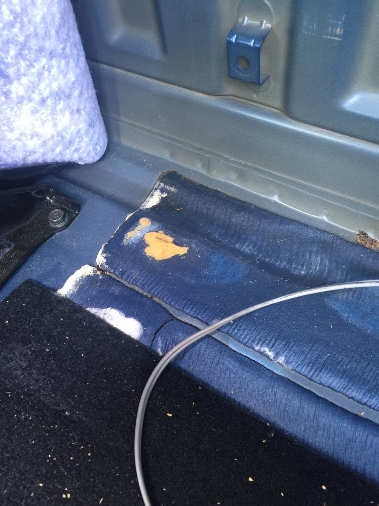

    Last two times it rained I noticed a smell of mildew in my truck. Decided to look behind my rear seats and this is what I saw...the last one is a picture of my subwoofer box after I pulled it out. Did a water test and water started pouring in from the rear vent on the back wall.
