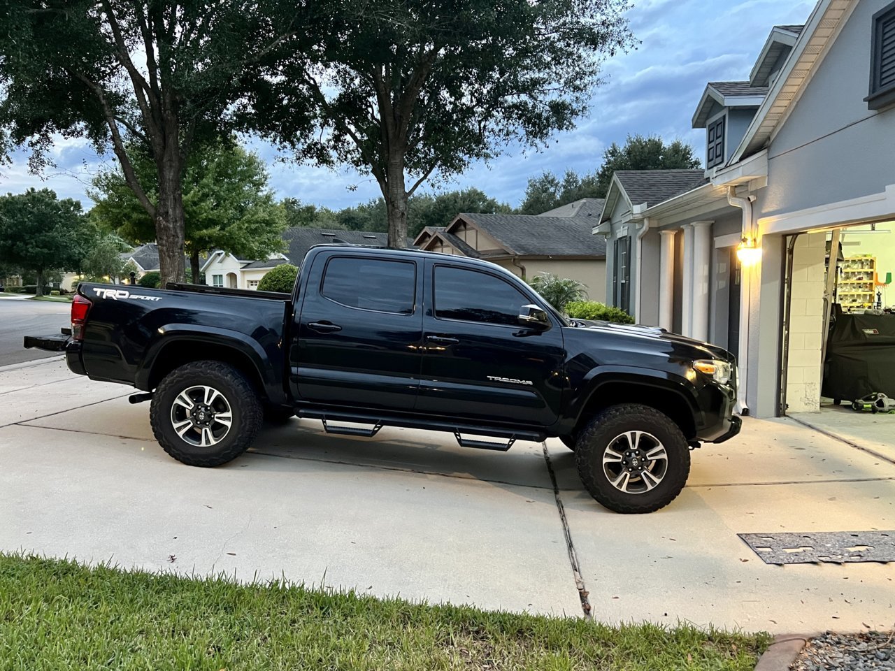

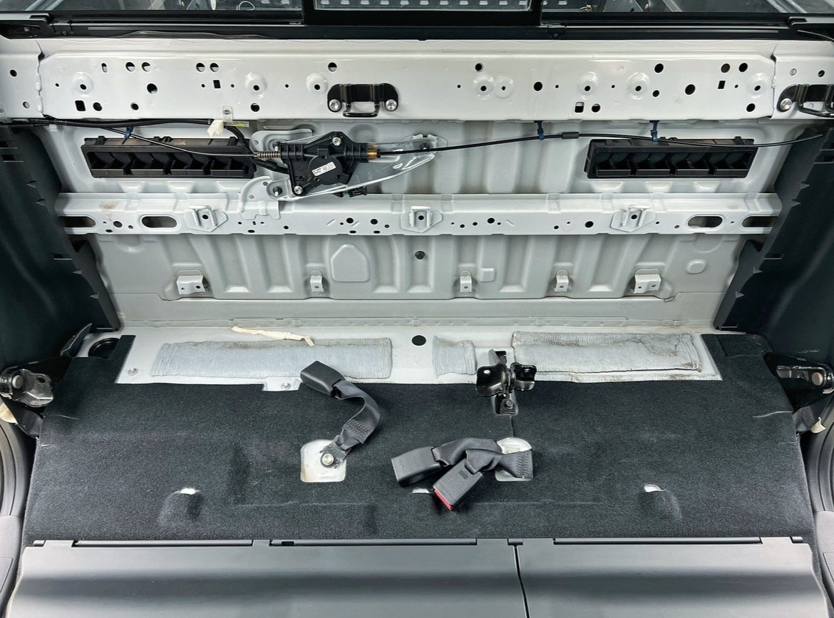

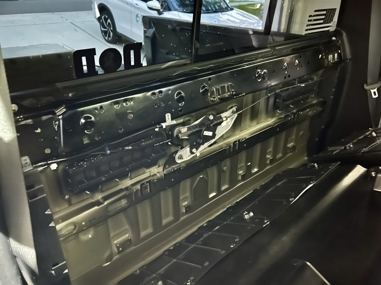

    I have this problem in my 2018 TRD Sport. I believe the issue is how the vehicle is parked when it rains. My driveway is on a steep incline and I pull straight into my driveway making the front of my truck face lower than the back. This position/angle makes those foam baffles on the vents let water that's flowing down the rear window right into the vent and drip into the interior of the truck. Testing my hypothesis currently by backing in my truck and seeing if the problem persists. Here are some pics of what I found and my driveway for reference:IMG_5333.jpgIMG_5334.jpgIMG_5335.jpg

    Have you tried parking it the other way and hitting the truck with a hose to note any changes in water intrusion?

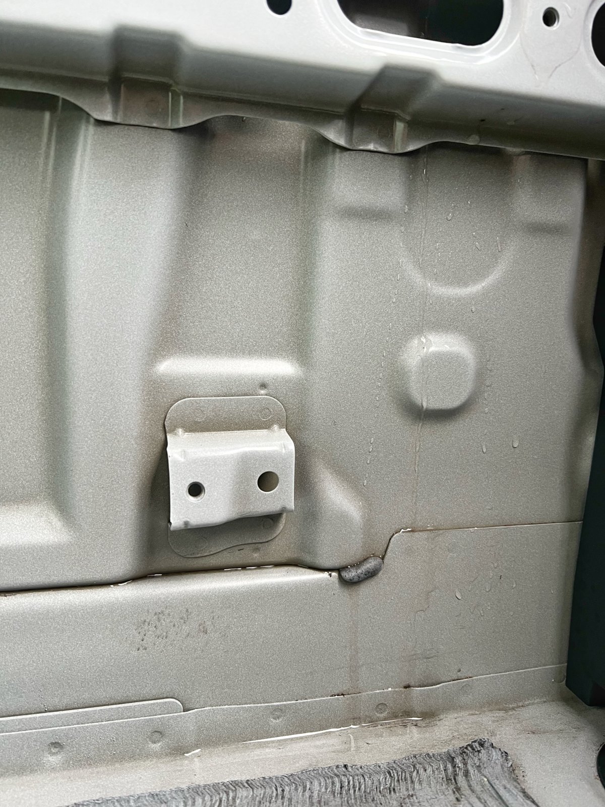

  17. Jan 26, 2024 at 2:53 PM
    #77
    VTi EG6
    VTi EG6 Well-Known Member
    Oct 17, 2016
    #200024
    529
    TX
    2017 Taco TRD Sport

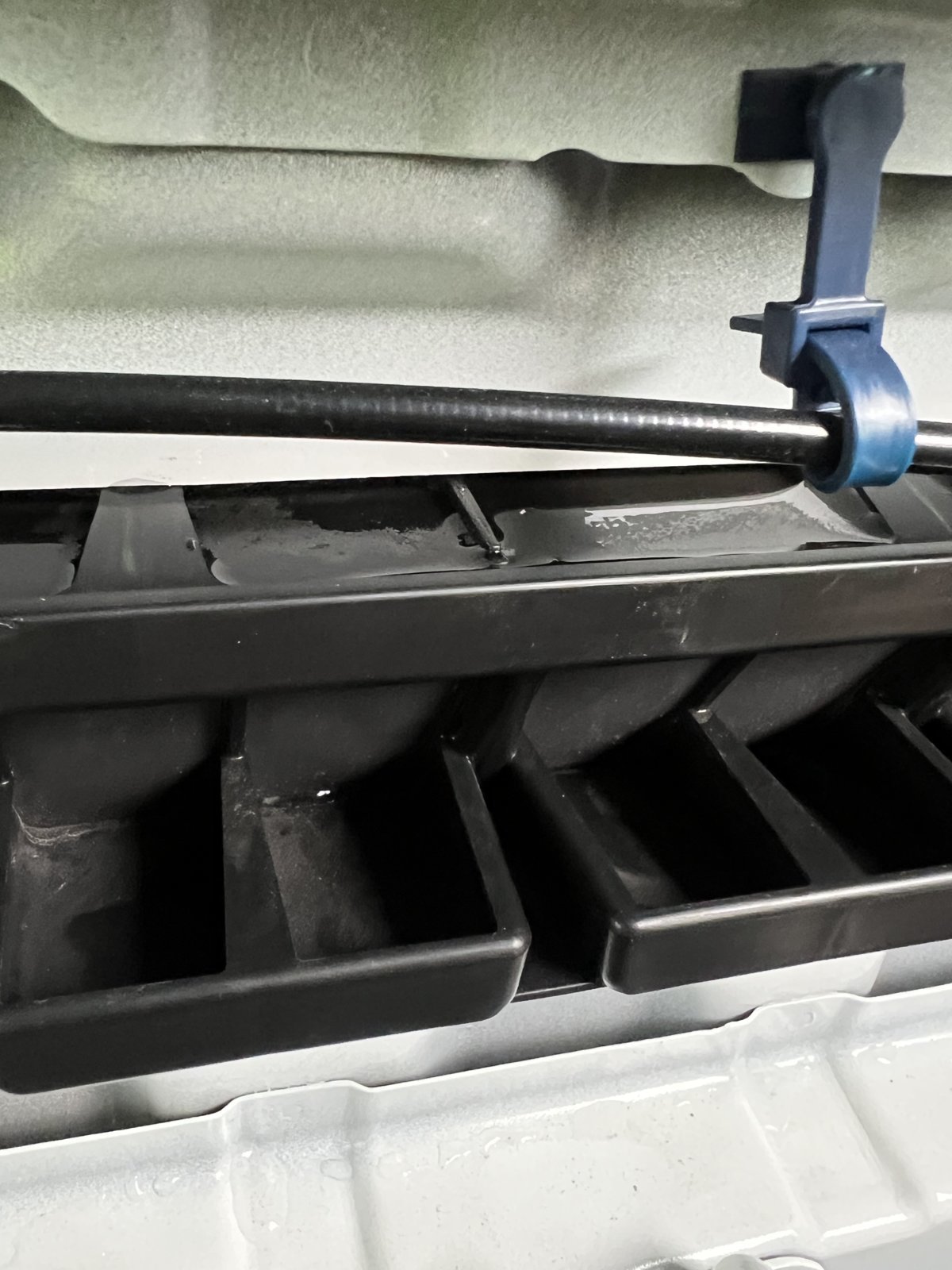

    Apologies for bumping an old thread. I never realized I had this leak til it rained nearly a week straight out here.
    (my 3rd brake light was fixed a few years back under the recall).
    Never had my headliner wet/soaked. I recently only found the rear lower seat/floor board area to be wet.
    Took out my back seats today prior to a light drizzle and discovered the following:
    I’ll have to wait until tomorrow to go purchase some silicone sealant as recommended by many of you here….

    Its a cheap design mine did the same because the vents were not sealed to the cab. They are only held in with those crappy little plastic bend tabs, get any outdoor silicone/cauk. I drilled a small hole on either side of the vent to attach a rope to it, then to the front seat to pull it tight while it dried.
