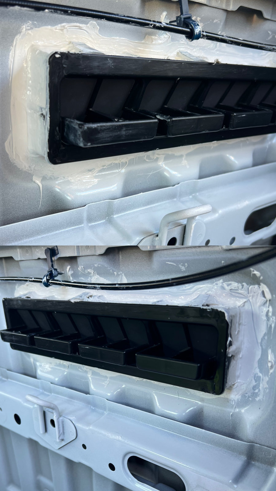

    Update: applied some loctite marine sealant yesterday… going to run the water-hose back there & hopefully I dont get any leaks. Not the nicest looking job. :(

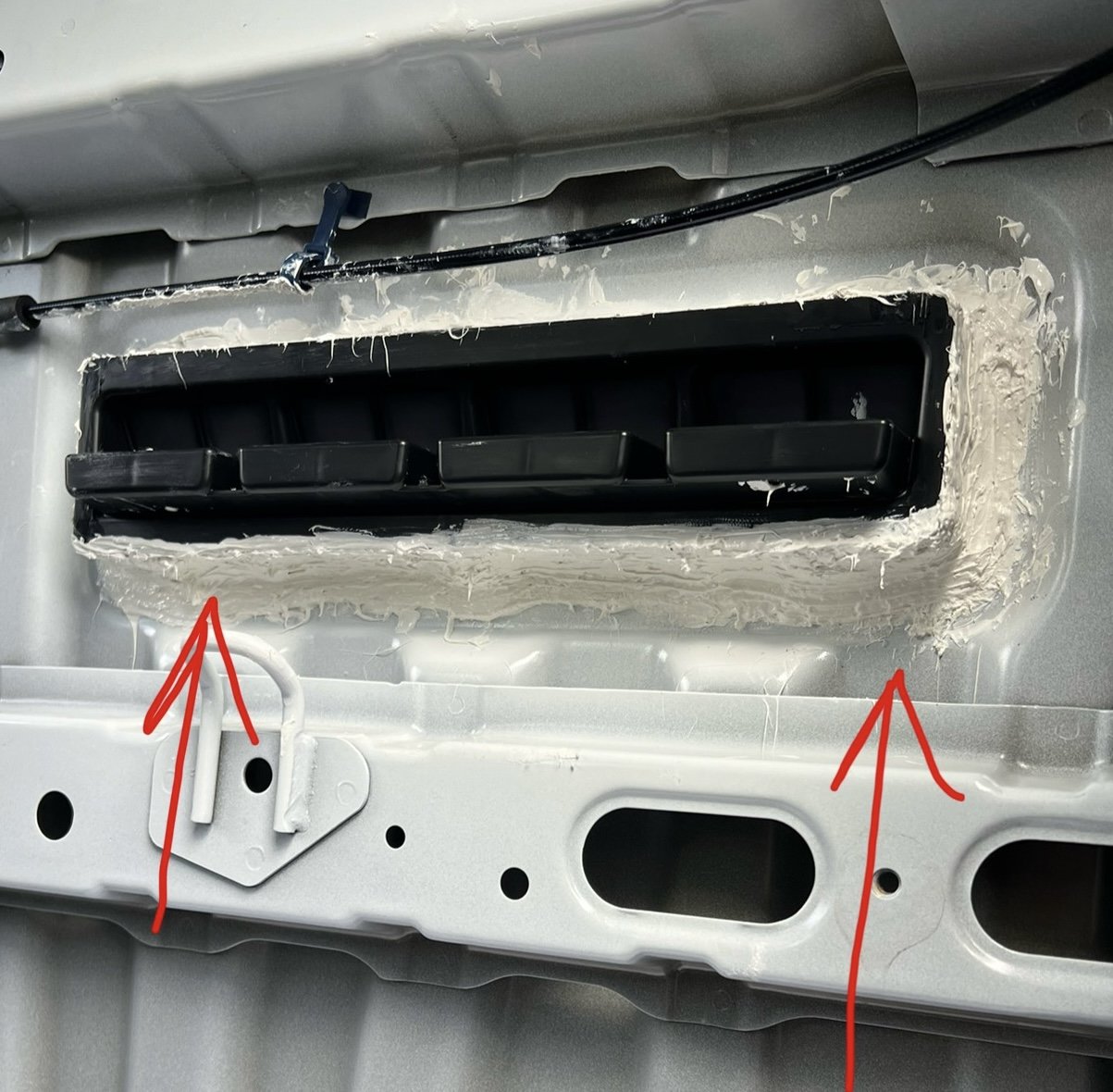

    It 99% sealed it. Went back and added more I missed a tiny spot on the bottom right vent clip where water still managed to drip. I’ll report back this weekend. It’s supposed to rain tomorrow and Sunday.
    (It looks like crap) but just hoping it solved the issue.
    You can see where the silicone fills in where the gasket is cracked…

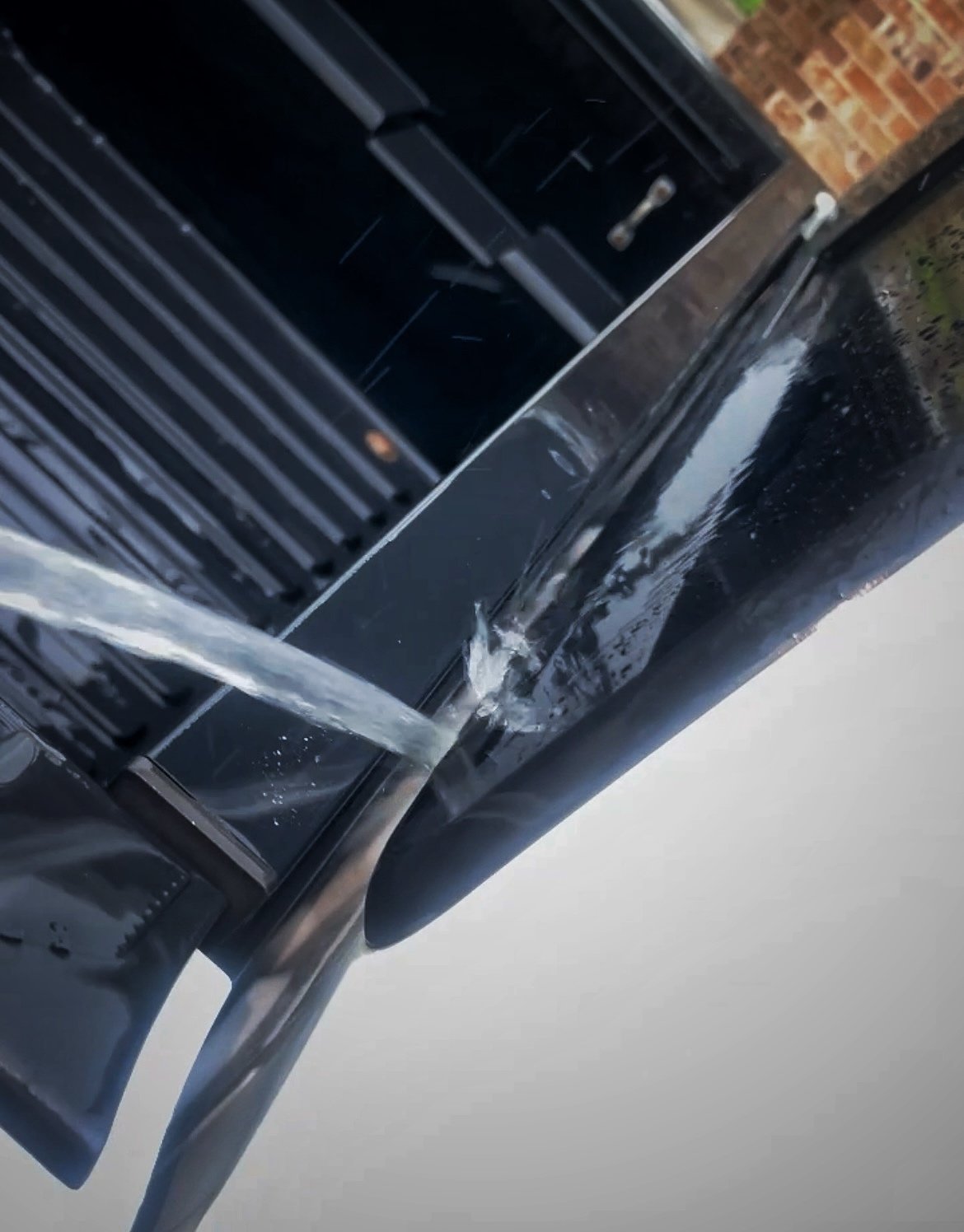

    Update: As of this morning, I used a water hose and flowed water on both sides for a good 5 mins. No leaks at all. Hopefully it stays put. Ended up using Loctite marine grade silicone.

    I tested mine this morning as well and I had two small leaks. I resealed those spots and will test again tomorrow

    I used the same thing that you used. I have used it before on my boat on some holes below the water line. That stuff is awesome
