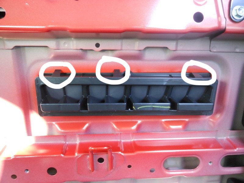

    This is what holds it in these thin tabs, the vent pushes through from the outside and tabs spring up and rest against the back wall on the top and bottom to hold it. Seriously cant believe this is the design, sure it is quick from a manufacturing standpoint but no way it will hold.

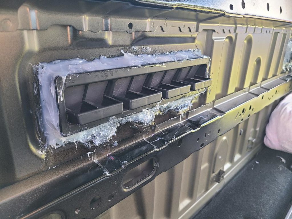

    The leaking cab vents were causing me grief until I found this and other threads and discovered the cause of the wet floor in my truck. A tube and a half of silicone caulk (and three tries to get them sealed) and I think the problem is solved.
    Thanks for the help info everyone!

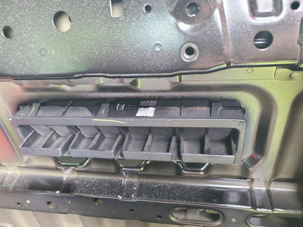

    I didn't get any really good ones, but here's a couple. wasn't real neat with the caulk! :D
    you can see some wetness along the top.
